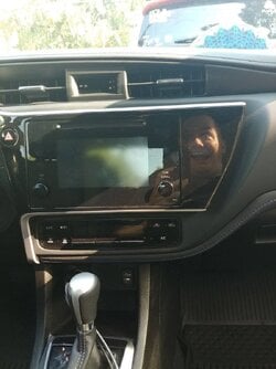

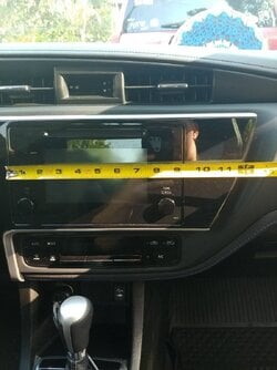

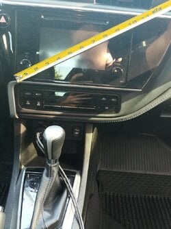

Here is what I am working with.
The corolla has a larger face than double DIN. I would love a large high res screen to fit in the space. The larger the screen the less of an ugly mounting ring I will have to put in. Could be up to an inch on either side if I use a standard double DIN. I haven't found a lot of double DINs with faces larger than the back. Probably not a common thing?
