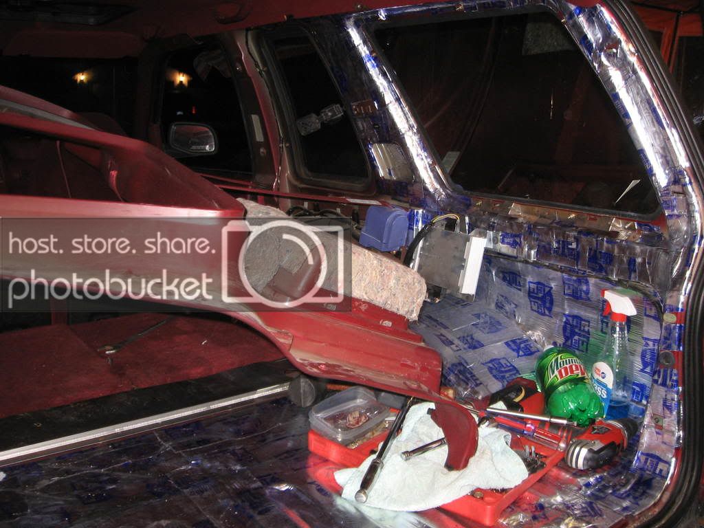

i finally started something on my build. (pics)

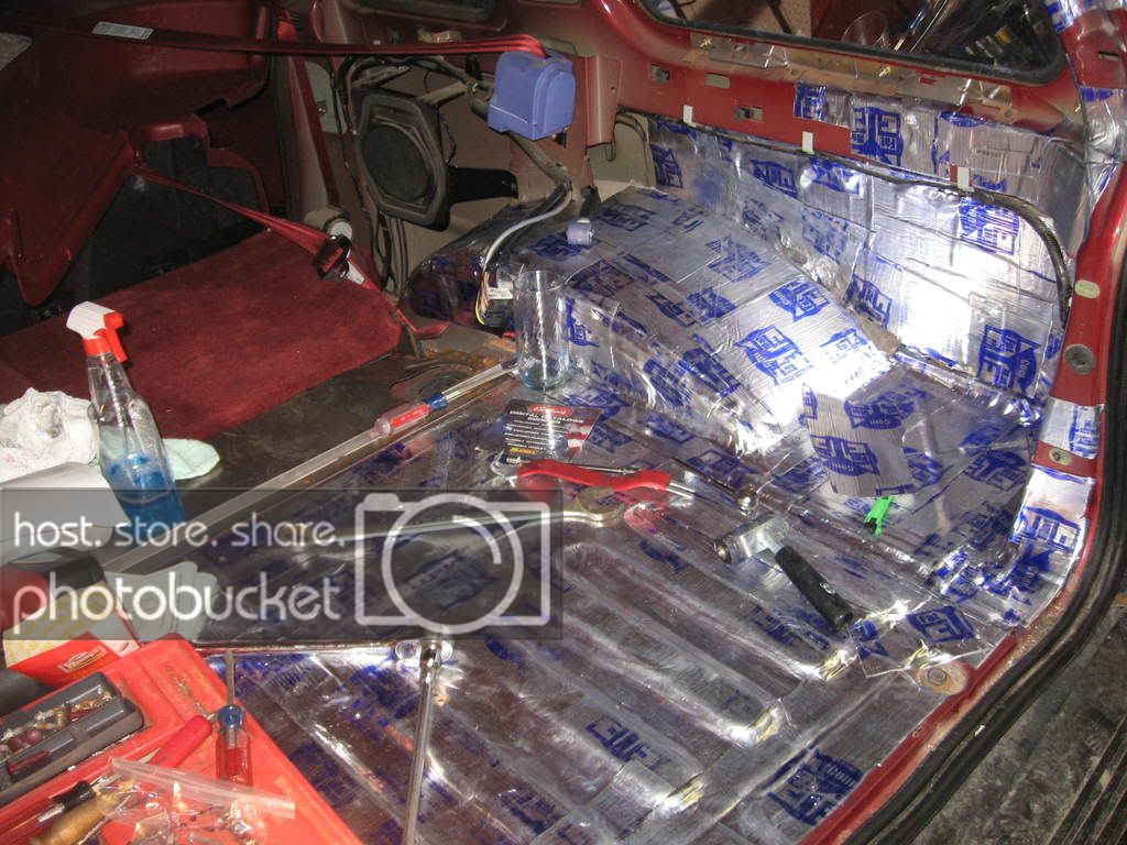

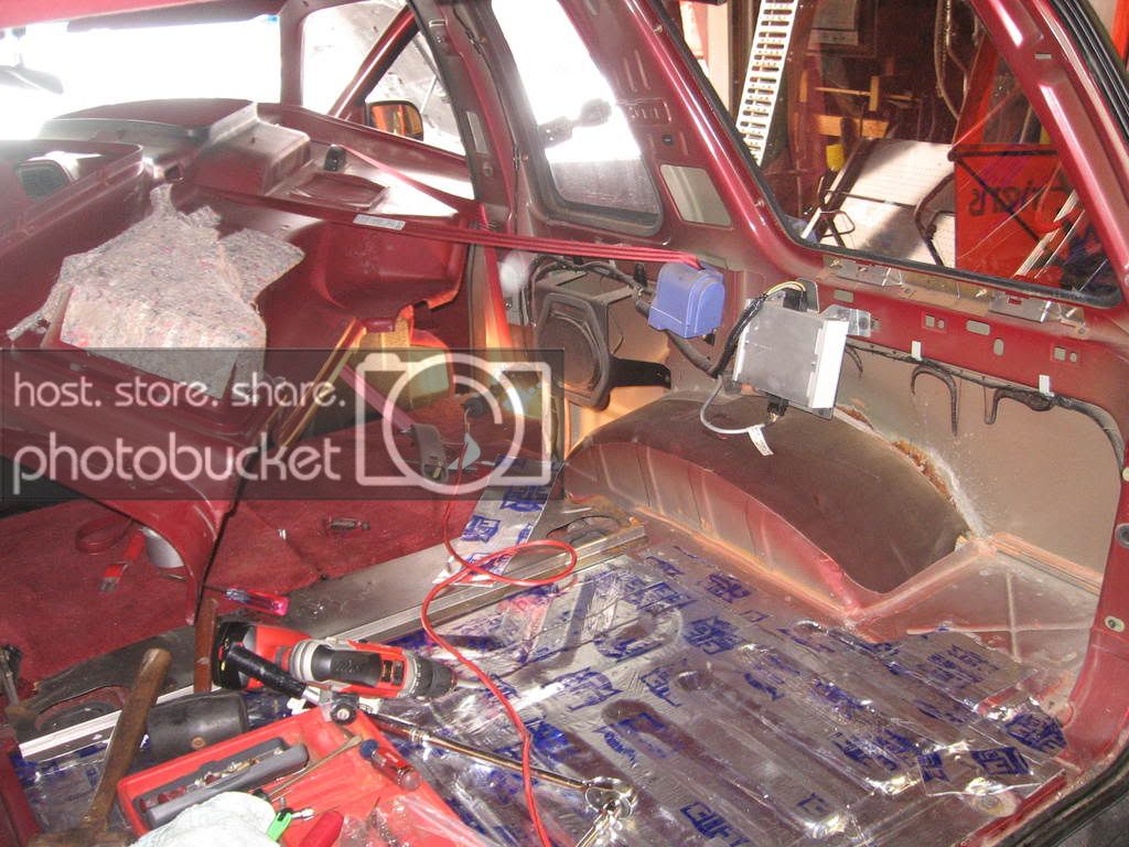

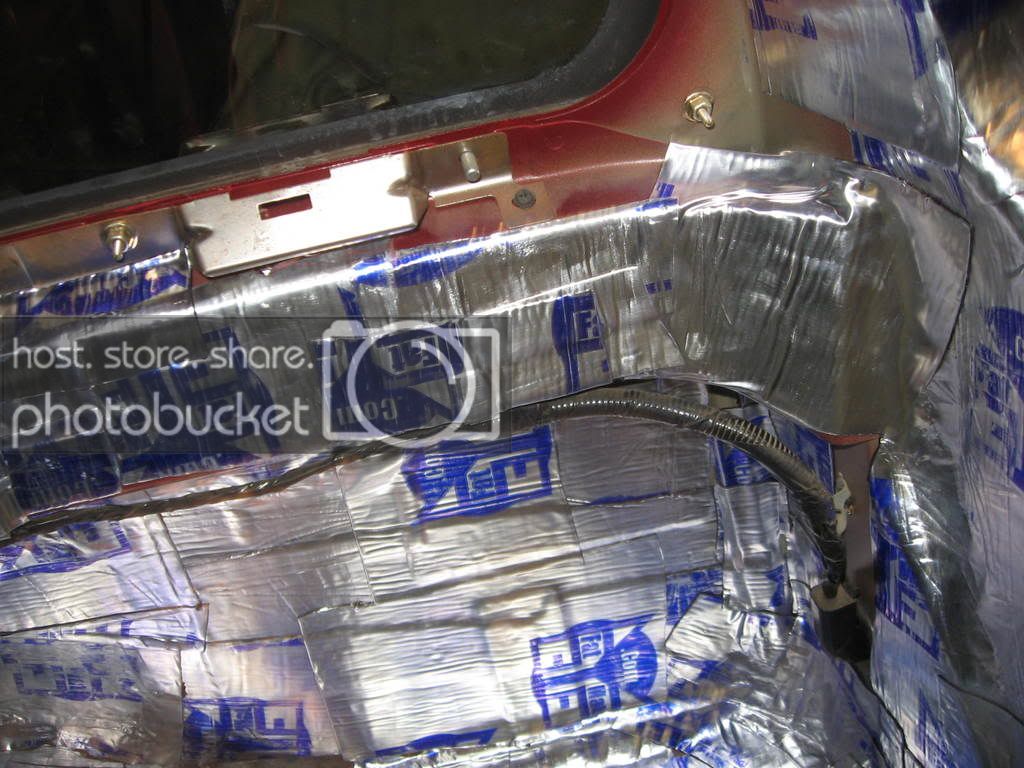

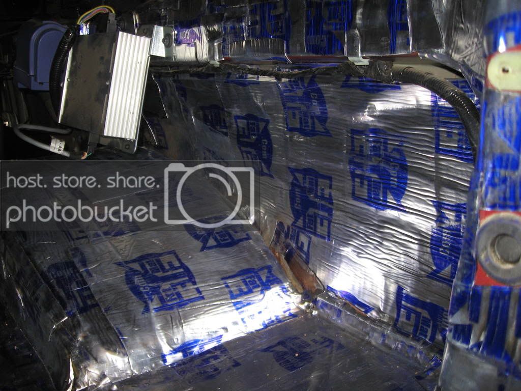

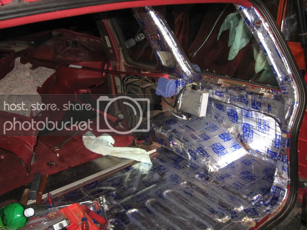

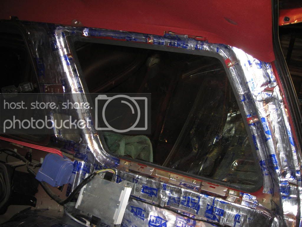

haha audioholic im not that dumb man come on now. bigbang i just rolled full 50 sq.ft. of it no odor at all . got another roll on the way though gonna do the hatch door plus on the doors and overkill pro to on the doors. Here's some new pics:D. working on the other side.
got everything packed up for tonight pulln her back in the garage. more work 2morro:D.

Install is looking solid.
haha yeah man that would be fckn funny as all can be though if someone actually did do that. Thanks man it's getting there glad i can finally start it been waiting 6 1/2 months. still gotta get a h.u. but that's it .

Install of the Mat looks great. It took a whole 50sqft to do the hatch area or what is in the pics? I have 100sqft myself, but have a small car in a Focus ST. So wanted to get the trunk, rear deck and at least front doors done.
Did you have a system in this before lying down the mat? Cause I have and I probably will be more critical than someone who hasn't had a system to distungish the difference.
Good luck on the rest of the install, looks great so far.

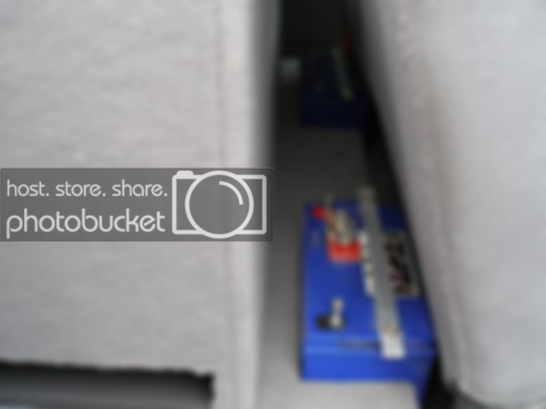

Im not sure what your batt tray is, but here's a pic of how I tend to mount batts (make or buy brackets and bolt it to floor or mounting board)..
I dont have the bolts put in yet to actually secure the batt(s) to the false floor, but Im sure you get idea from seeing the bracket. I made those brackets (obviously) but you can generally buy adjustable length brackets at any auto parts store. Should come with long J-bolts. Buy some eye-hooks to secure to the floor or mounting board, then secure batt/bracket to the eye-hooks. Viola.
bigbangtheory, generally speaking butyl rubber mat wont smell. It does have abit of an odor to it, but nothing like the old asphalt stuff did. What always made the aspahlt stink was the heating process for applying it, that's not done with butyl mats. No heating, no melting, no stinking.
Oh alright thanks for the idea audioholic. Bigbang thanks man it's getting there that was only 50 sq.ft. there i just ordered another roll last night so i can do my hatch door , finish up the back and doors. it doesn't have any odor at all and i was heating it up before i layed it sticked great also also just make sure the surface is clean before laying it also. mine had alot of dust dirt etc.... so cleaned it all up. works great though and no i didn't have my system in there yet still waiting on a h.u. so i can do my install:D.
