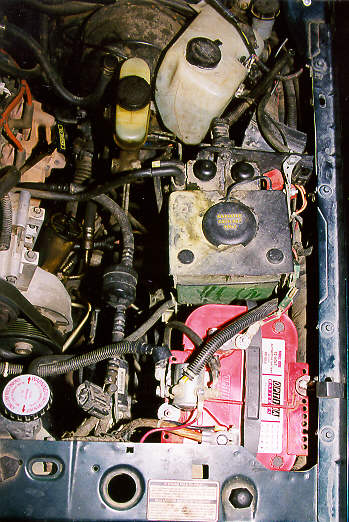

well guy's after much looking here is what i found.
Adding an Auxiliary Battery
Where in the heck did you find the room to mount a second battery?
I removed the stock windshield washer/coolant tank and cut the tank apart between the two separate compartments. I discarded the washer fluid tank and kept the coolant tank. I then mounted the coolant tank to the Explorers fuel tank vent, which has two round plastic caps on top of it. The coolant tank is now attached to the vent housing with a piece of perforated metal strapping.
With the coolant tank relocated, there is plenty of room for a second Optima battery. I mounted a steel battery tray to the inner fender using a block of wood as a spacer to hold the tray level. The wood is bolted to the metal ledge and the tray is attached to the wood block.
I replaced the stock washer fluid tank with the smallest tank I could find at a junkyard (I think it was out of an old Dodge). I mounted it next to the master cylinder, towards the fender.
The second battery is charged using a continuous duty solenoid as the isolation device. With the three position switch mounted on the dash I can charge both batteries, isolate the auxiliary battery, or jump start myself.

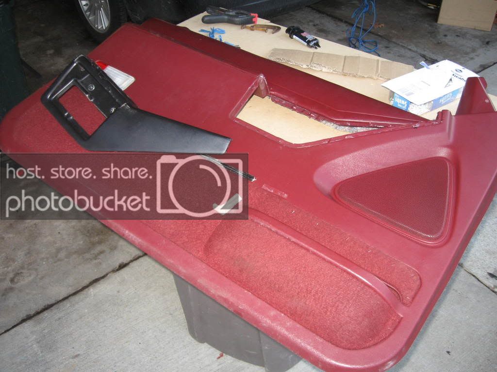

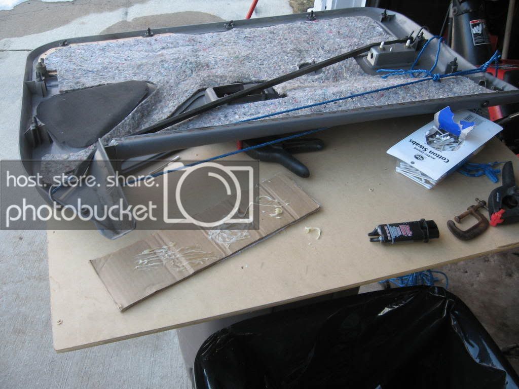

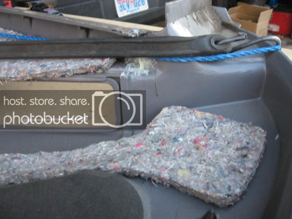

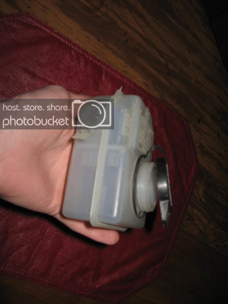

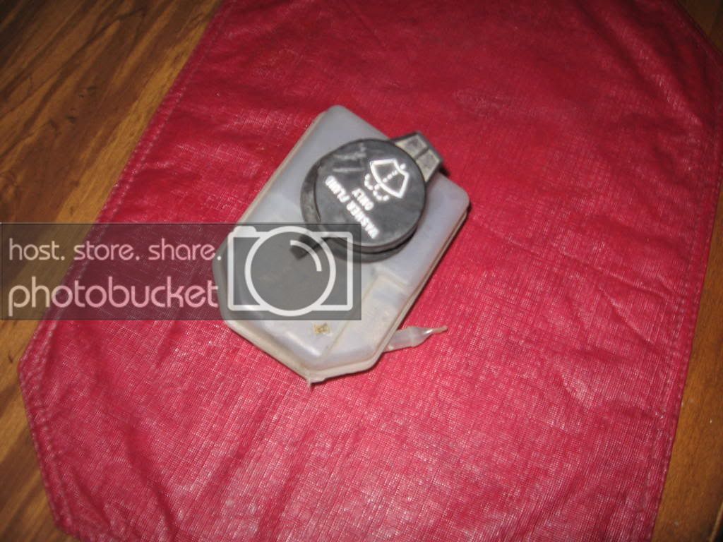

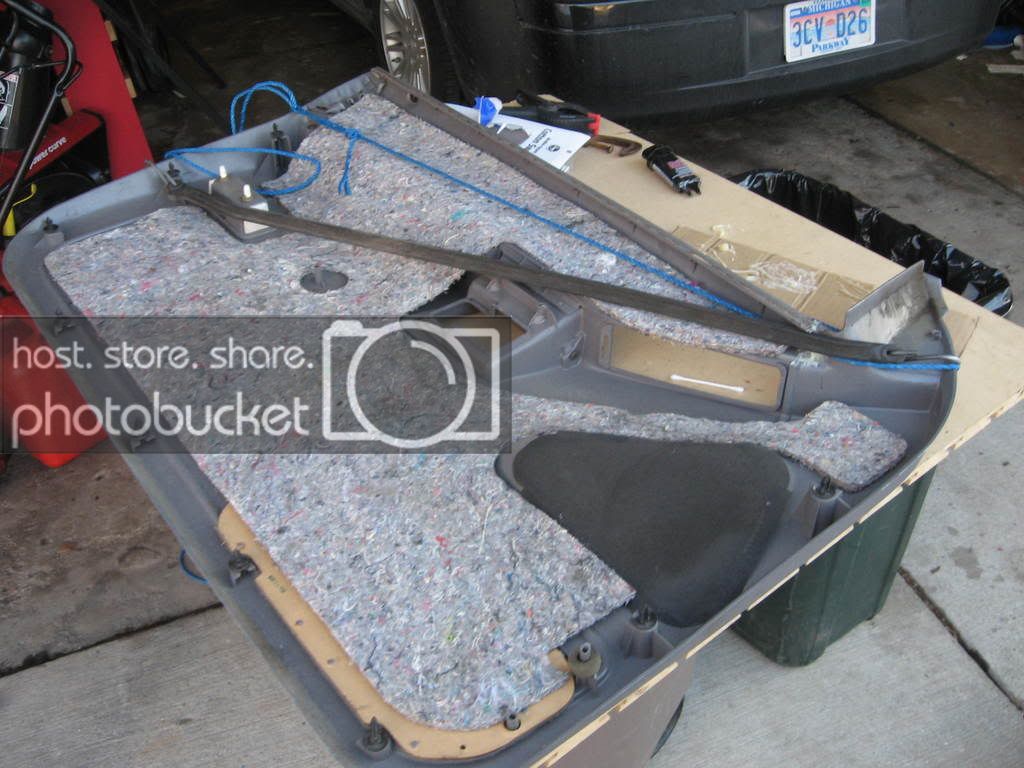

i went to the junk yard and got this really small windsheild washer fluid resvoir to conserve space , so that i can cut the windshield/coolant resvoir down the middle save the coolant one where it is but remount re-run tubes for windsheild washerfluid resvoir. I know it's tiny hahaha (Not what she said though;) haha ). but also i don't use the windsheild washer fluid that much anyways so not like i need alot of it. it came off of some smaller car i found in junk yard i don't even remember which one. Just gonna re route the windsheild washer fluid lines. I also got another passenger side door panel i fixed it was glueing it today also i will also paint the gray panel the same color as the car went and got a color of it. was working on driver side one today but the arm rest was so totaled i couldn't save it so 2morro back to the junk yard hopefully i can find it. (well onto pics 4 u guys).
Took off old arm rest because it was in pieces basically broke so like i said 2morro hopefully i'll find one at the junk yard.
