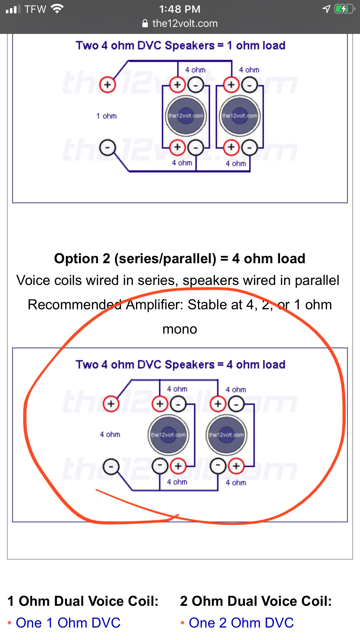

-Subs are wired together to push out a 4ohm load in bridged mode

Check your sub wiring for the 4 ohm load and make sure you are not wired towards the 1 ohm load.Your amplifier is only 2 ohm stable as you state. You should be running the REMOTE Wire Off The HU with no inline fuse, Straight wiring from the HU to the amplifier, (wired off the battery, its on all the time running and car sits long enough, the battery will drain.)Never heard of 5 ga wiring.Ill have to google that one up.(New on me).If its 4 ga, that plenty large enough for that amplifier.thats a 2 ohm stable amplifier.ToBridge properly, you should have the Poss.(+) wire going to R+, and your Negative(-) wire going to your L- to be bridged with the Crossover Mode set on LP. Tune accordingly
This is exactly how the subs a wired here, so it is a 4 ohm load.

This is a strange case. Impedance is on the safe side, it seems as if your amp is rejecting the 13.8v when the car is on. Try disconnecting the remote wire and reconnecting after the car is on. If no go, try relocating to another fuse. Some fuses have power in accessory mode, but lose it when car is turned on.
