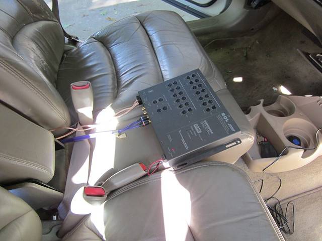

An external EQ has the advantage of letting you keep the HU flat, which gives you maximum volume control range without clipping at the source. This is why we always say to turn EQ down rather than up, so you don't boost some frequency into clipping. Whether your 8 bands is enough for that is something you have to experiment with. With an external EQ you're dealing with the headroom of your amp, which makes it possible to boost without clipping. Much more intuitive.
Its easier to tune from a HU than an external unit.
True, that. I'm sure I'm not the first to ride around with an EQ on the front seat for a week before doing a permanent install..
