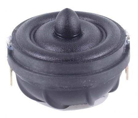

i'm not saying you have to break the bank with a front stage, certainly, it can be done for a lot less. Hell, I put this together and it sounded great for $150 total:
Vifa OT19NC00
Dayton Reference RS-100
Silver Flute W17RC38-04
I ran them with a pair of xtant 403a amplifiers, active with an H701. So you figure after $2k worth of processing and amplification, and hundreds of hours of vehicle modifications - I can make decent budget speakers sound great.
reasons:
I've ran the Vifa ring radiator back when i ran the Alpine SPX-177R. they are better in spheres.
I like Dayton audio drivers and i like a dedicated full range (midrange) in the kicks. i will locate these more on axis (and play with aiming) and may run with just a high pass. they are good to 10kHz on-axis but with most door speakers they roll off above 3kHz based on beaming and off-axis response.
I heard great things about the Silver Flute drivers in a midbass application - and they delivered once properly installed.

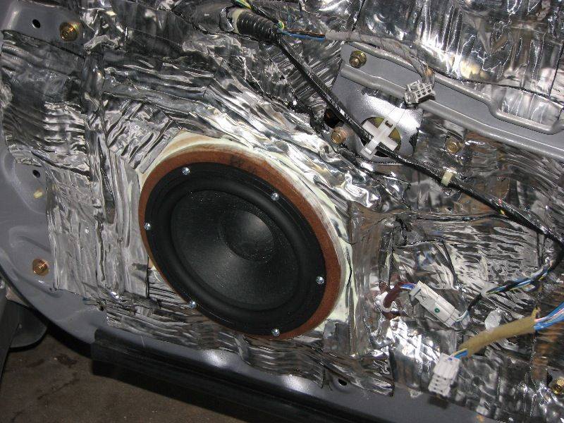

putting the large midbass in the doors of an Accord required some modifications (including removing metal)
fully sealed, deadened, and with pvc encased fiberglass batt absorption
but then I ditched them and went for German Maestro Status SV6509.
good, but not good enough.
Now i'm installing Hertz Mille MLK-165.
During the interim of changing speakers and amps, I ran the Silver Flute and Vifa tweeters off the head unit directly (just caps on the tweeters for HPF). And it sounds decent - surprisingly so, but I already had the investment in time and effort making the doors sound amazing.
midbass requires an outstanding enclosure. a Q-form is a terrible midbass enclosure. you can get away with a dedicated midrange only, but you'll need to use doors for midbass. a 3-way is a good way to get more output with good clarity since you use a dedicated midrange.
you want a 6.5" speaker for the front. Buying from Crutchfield is a good idea since they will give you the required mounting adapters and wire adapters. the factory speakers has a large plastic housing so you cannot simply screw a new speaker in-place. a mounting adapter will secure to the door then the speaker attaches to it. i use weatherstripping foam to seal and isolate each piece. seal adapter to metal. seal speaker to adapter. seal speaker to door panel (foam on the front of the adapter that meets up with the door panel (just like stock). these seals are required for good response.
