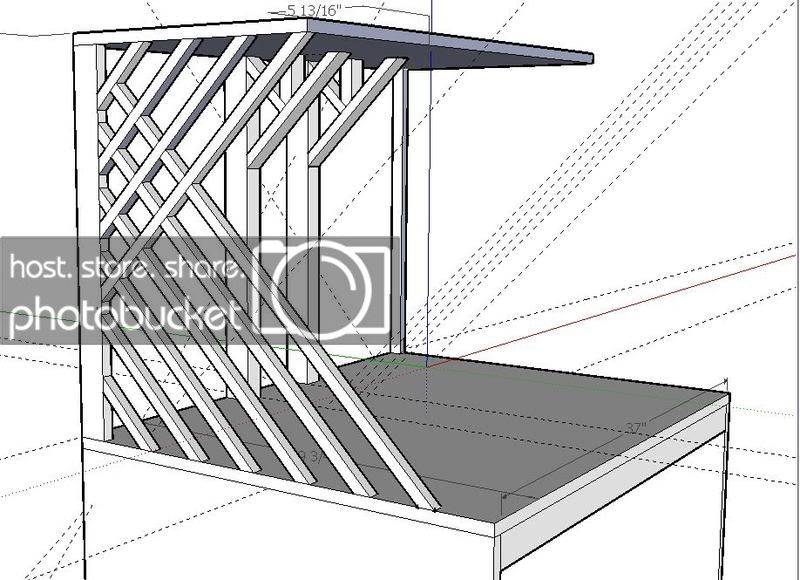

Since you're only going to have a few things on the shelf, you should be fine as far as supports. I would still beef some things up a little. Check out this picture of yours that I modified:
The red line is what I was meaning about beefing up the 90* support. I wouldn't double it as in thickness (1.5" instead of .75") but as in length. I would also add a single blue support for the middle of the shelf so it doesn't sag over time (which it will no matter what kind of wood you use). It doesn't have to be elaborate like the sides but something is needed there.
If you can't do a support like the blue one pictured, I would definitely run some parallel braces under the top panel. Make sure to make them about 2" tall and attach them perpendicular (like a T) with the top panel.

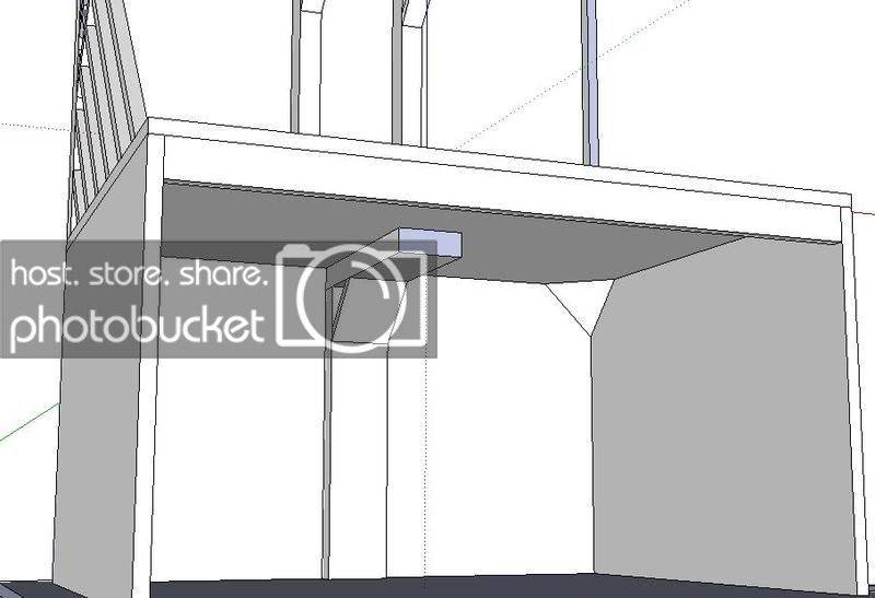

[ref img: made the beams bigger and added 2 heavy duty middle supports]
[ref img: added support on the bottom to hold up the other weight]
