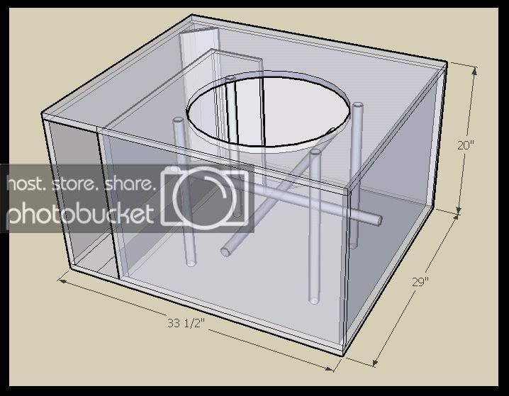

How does this box look for an 18" Fi Q?
Pickler
It is 6.5 cufeet internally tuned to 30hz with 111 inches of port area. What is your guys thoughts on it? to much/to little port area? not enough room inside the box? just post what you think on it.
I would do a double baffle for an 18, and that would eliminate some of the bracing you have in there. Also a little on the big side port wise. I've built boxes for several Q's and have always done 12^2 per cube...
I figured with it being an 18" Fi Q, that it would need more port area, but I don't have any experience with them.
Only 12sqin per ft^3?
He is wanting to get more net volume anyways, so we will probably change the design a bit. Smaller port, more airspace.
I figured with it being an 18" Fi Q, that it would need more port area, but I don't have any experience with them.Only 12sqin per ft^3?
