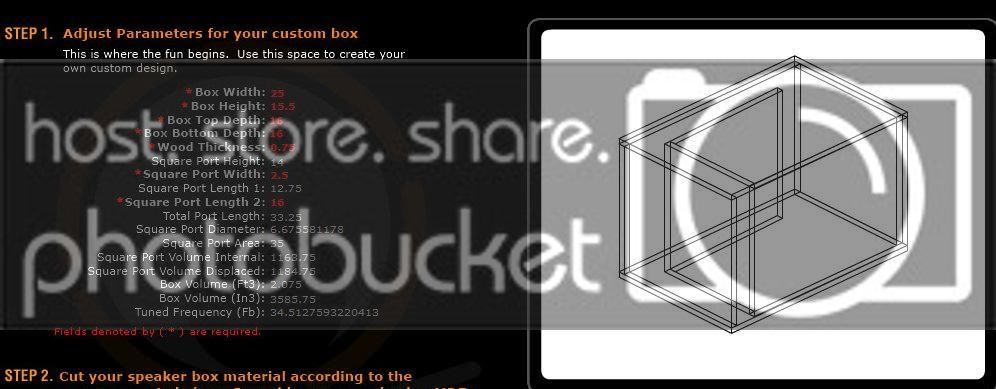

mobeious 10+ year member what does 0hz feel like? 4,963 5 Bartow, FL Jan 21, 2009 #17 the box size really depends on power i would do 1.5-1.75@34-38hz if i were u but what do i know //content.invisioncic.com/y282845/emoticons/rolleyes.gif.c1fef805e9d1464d377451cd5bc18bfb.gif
OP FurbiesAndBeans 10+ year member CarAudio.com Elite 2,075 8 Corona, CA Jan 21, 2009 Thread Starter #18 OK, so i've decided to make the box 2.075 cu. ft. @ 34 hz with 35 sq in of port area. What power should i be looking at to throw at it? 650? Here's a picture of it (i used RE Audio Box Calculator)
mobeious 10+ year member what does 0hz feel like? 4,963 5 Bartow, FL Jan 21, 2009 #19 id really consider 1.75 with 600 watts
OP FurbiesAndBeans 10+ year member CarAudio.com Elite 2,075 8 Corona, CA Jan 21, 2009 Thread Starter #20 id really consider 1.75 with 600 watts Click to expand... Why? i thought they were underrated. Im not set in stone with the box, i just thought it'd be better to throw a bigger box at it.
