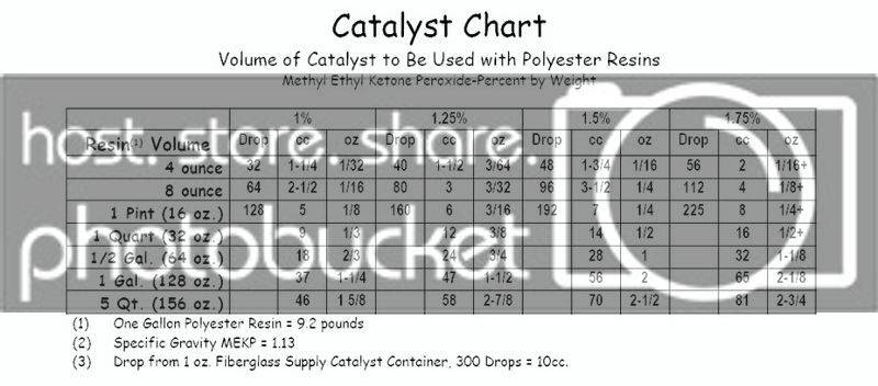

Just wanted to get some ideas from others on how they mix?I use a pint paint mixing cup to measure the reason out then depending on the amount I use (i.e. 4 oz or 8 oz) determines the amount of squeezes of MEK I put in.I know this isn't the best way but it works.But I would like to make it a little more consistant so I ask what you guys do:)Thaks
Check the chart:
Use a medical syringe (without the needle) or a baby medicine dispencer. Both measure in CC's, and both work excellent //content.invisioncic.com/y282845/emoticons/smile.gif.1ebc41e1811405b213edfc4622c41e27.gif
