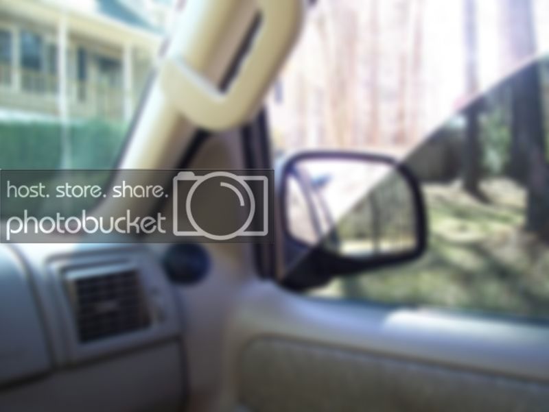

Here is where mine are. Overall not to bad. Sometimes they can be a little harsh on the ears but when the bass is up it usually doesnt sound as harsh.
