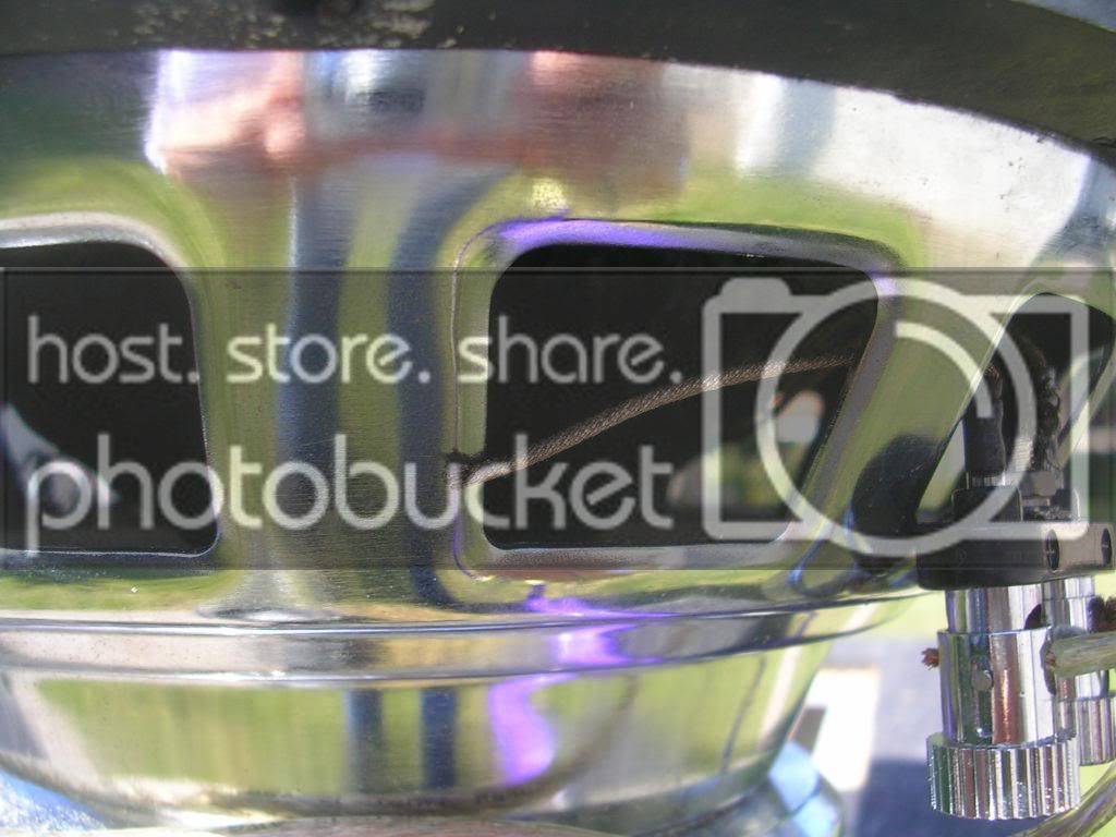

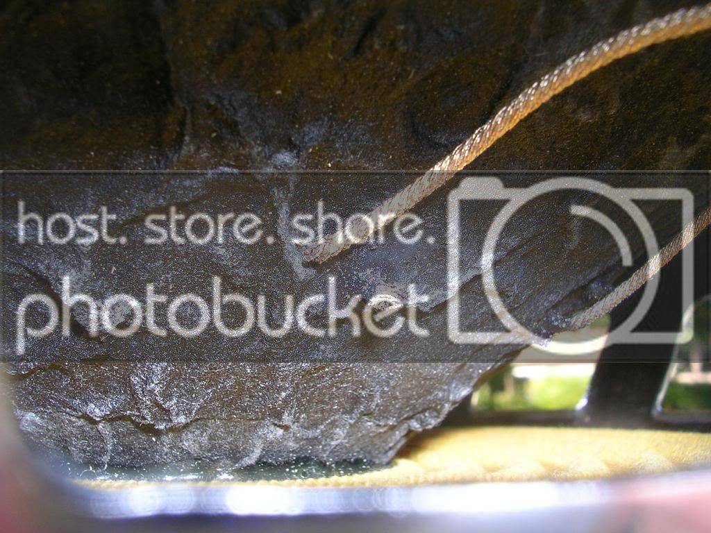

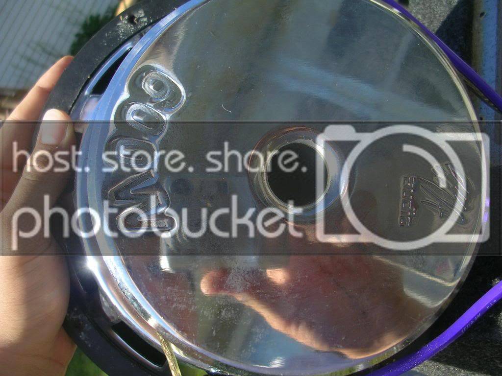

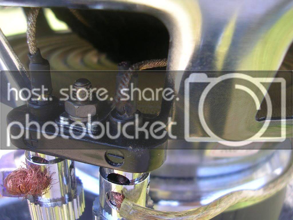

I assume you guys can help me, how do fix this? i dont know why or how but these things were loud when they worked. What is that wire called and do you have any sugessiontions on what i should do from here? also is it normall fo the wire to break from the terminal like in pic 3? i re-soldered it on there but it did it on both the subs i have. They are 600 matt MA audio 10's.
amp was rated to send 380 RMS and i didnt have the gain high right in the middle and rated for 300 and i am sure they werent getting 380. as far a clipping i dont think they were but would i be able to hear it?
Those wires are called tinsel leads. You are pretty much screwed on the sub where the tinsel lead snapped off at the cone. There isn't enough tinsel lead left coming out of the cone for you to really re-attach the other end of it. The one that snapped off of the terminal you can re-solder but it will be a little shorter and run the risk of snapping again.You could add a small length of wire to it and then resolder it but not too long otherwise then the leads may touch and cause a short.Looks like you have had those subs for a while. Might be a good time to invest in something newer/better

ok then what do you recomend as far as tens go? i REALLY like MA audio i have had these tens a a few 12's over the past few months and really seem crisp. if i can re-solder the one that broke off the cone will it be ok as long as i exten the lengths of them?
Broken tinsel leads can either be caused by excessive wattage, causing the wire to melt... or excessive excursion, causing the lead to simply snap in half. Excursion problems could be due to enclosure size, and/or SSF settings if its vented.

that can be fixed but not really worth it. the new dust cap and good lead wire will be worth more than the sub itsself...
cut the dust cap off and connect new one at the vc or pull the lead thru the cone and resolder on new lead wire.
thats almost what i did looking at the pic closely you can see a lil of it poking out of con so i got enough out and i actually got it back on and they slap again, time to sell them to some dumb suburban kid.
