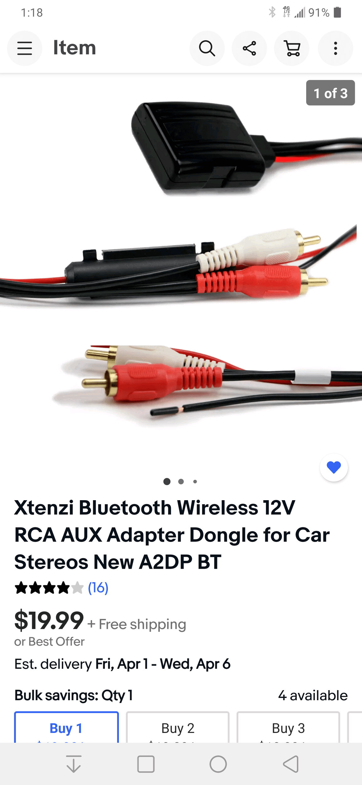

I see the tablet has BT. You can use a BT dongle straight to the amp. I use one in my home set up.

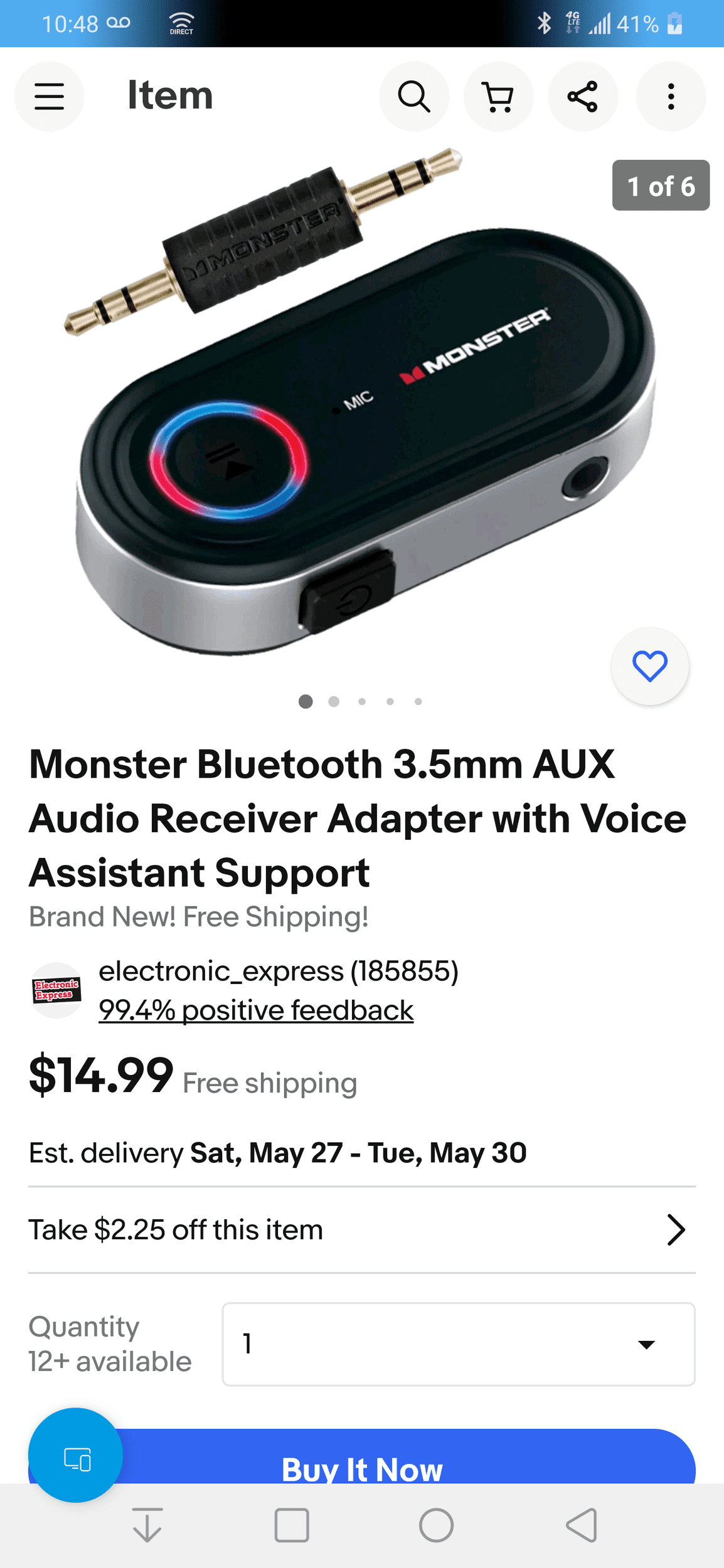

This is the one I use at home. I charge it periodically
