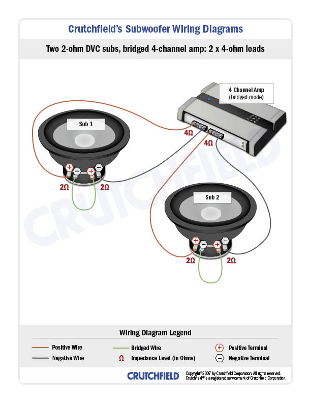

hooking up solo-baric 12's
I see a pick of two 2ohm DVC subs. Each wired in parallel (1ohm) then hooked up in parallel to the amp (.5ohm). Perhaps that's why it doesn't work?
They prolly ment to show a pick of wiring each sub in series and then hooking them up to the amp in parallel (for 2ohm load).
Click here for some wiring diagrams.
Also, use 12 awg wire if you run a single wire to the subs and parallel them in the box like the kicker pic showed. Or you could use 14 awg if you run a separate wire to each sub from the amp.
Did you smell smoke? .5 ohm load is pretty big load for a 4 channel amp bridged.
You need to wire each speaker in series to make each sub a 4 ohm load, then put one sub on each channel of the amp (bridged to 2ch).
If the amp is fried, find a good mono amp that puts out it's highest RMS at 2ohm load. Wire the coils in series and run them parallel to the amp.
if that pic is wrong how are you saying to wire them? could you send me a link to wire them up right..
You'll have to use the example above for that amp as well. The Punch 360.2 does not say it is 1ohm stable per channel, nor 2 ohm stable bridged. It would however push 1 sub @ 4ohm bridged.
