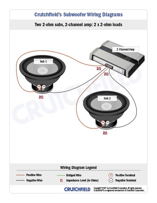

I already did some research - does this look like what I should do??
The PG amp has 2 sets of speaker outs. It goes L+ L- R+ R-
There is a line between the L+ and the far outer R-, which says BRIDGED
Is the "bridge" actually done by wiring the speakers in series, and using the outer terminals?
Or can i hook both speaker positive to the outer L+ and bothe negatives to the R-
Or am I tripping on drugs and should do what the crutchfield says (do the #'s match up with my setup)
It should be at 300w each sup with them wired like in crutchfield pic?
Is this pic applicable to my setup?
Is this a "bridge" and i can use this as one channel on my amp?
or stick with the first pic in my original post?
Thanks in advance
dude it was not answered
whats better, bridged or stereo?? Or is it the same?
DOes that bridge pic apply to my setup?
bridged is better, connect the subs so there is only 2 wires and connect those 2 wires to the amp brdged,....if the amp is 1 ohm stable
oops, that doesnt help, jl reccomend NOT connecting different drivers in series, looks like your best option is connect each driver to your amp seperately.
