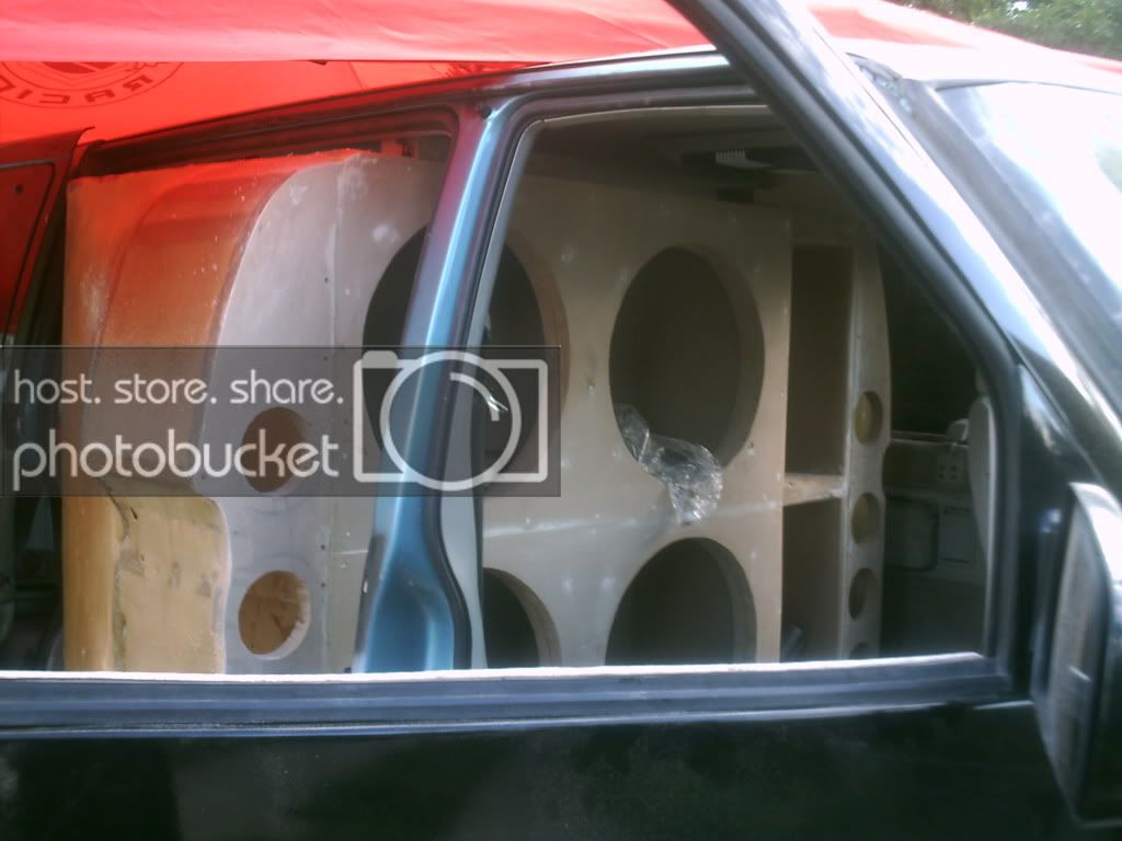

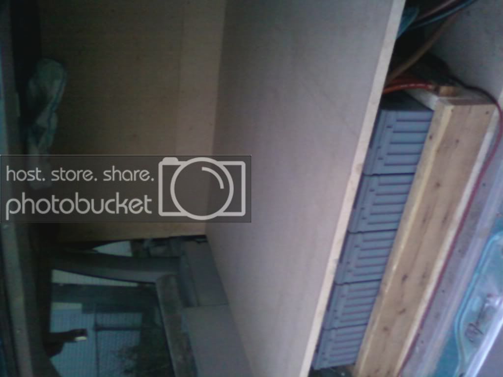

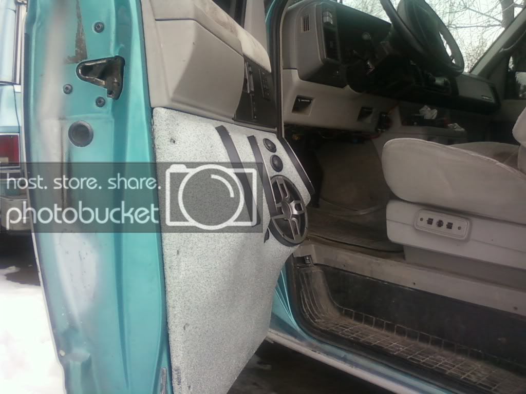

so here is the beginning of the new build LOG. so here is a taste
i have

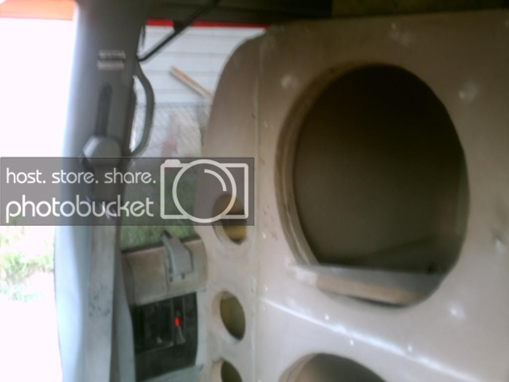

4 custom 18in Konaki built by (R.I.P.)
Enclosure is 30sqft, Port is 360cubic inches. tuned to 40hz

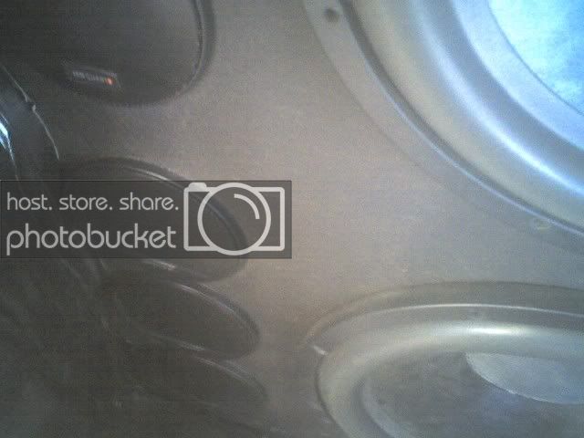

1 soundigital SD16kd (16000watts)
8 6.5" Mids (mb quart)
8 5.25" Mids (mb Quartz)
16 1" dome tweeters
2 Mb Quartz 4125 (1000watt)

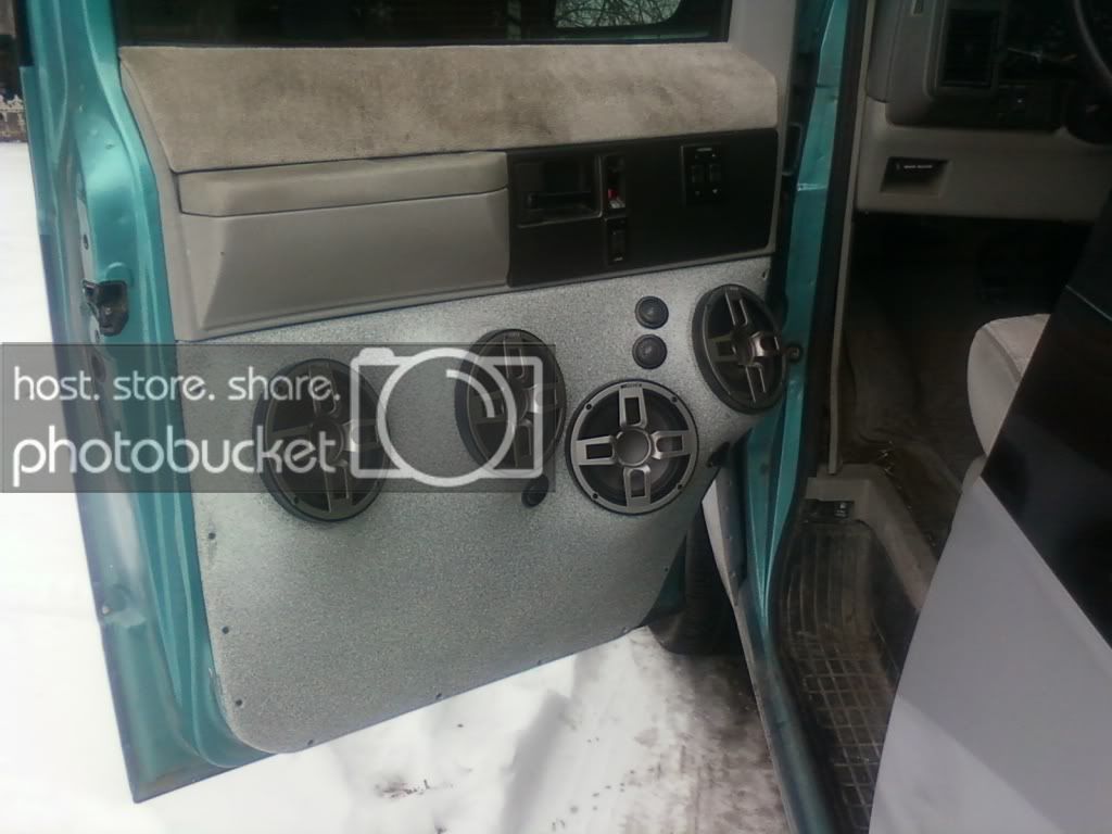

All in custom made Door Panels made by (R.I.P)
220 H/0 Alt
2 runs of 4/0 (not 4 gauge) from Alt to back
1 Kenetic 2400 up front
10 C&D 134Ah batts in back
Loadlifter 5000 Airbag helpers in back
