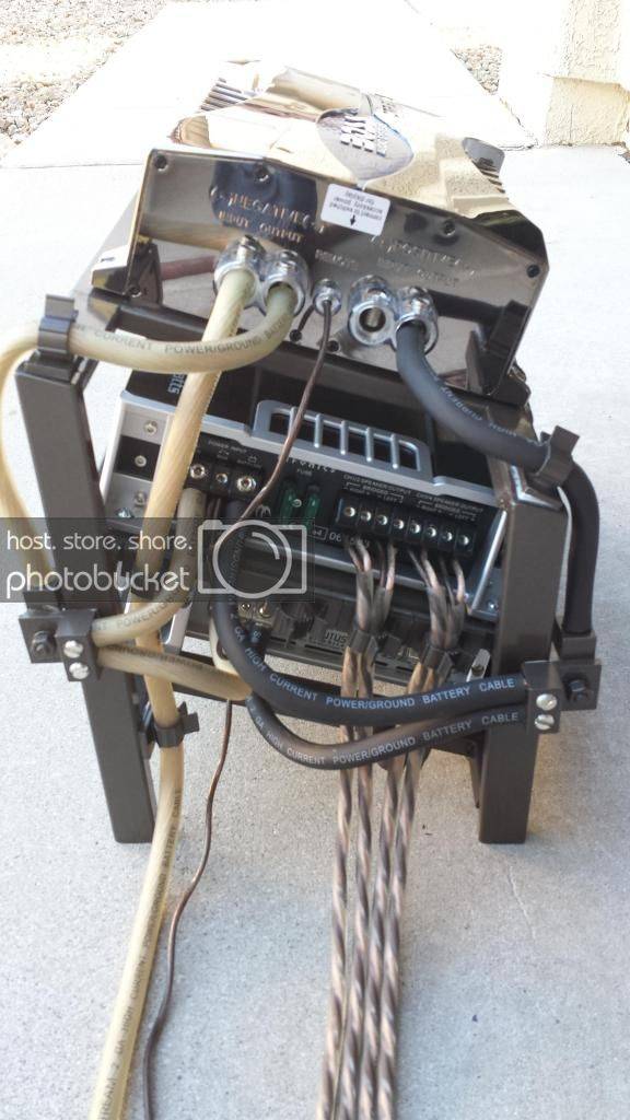

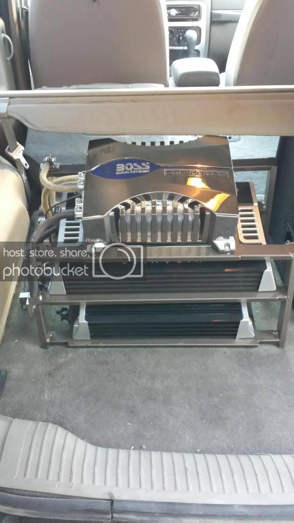

also I decided to build a quikie little amp rack the other day so I didn't have to fight for a place to put everything plus I made it so it can be removed fairly easy.
here are some pics of what I did.

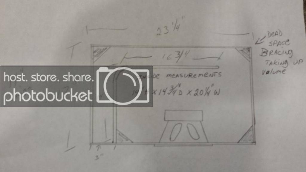

this is my ported desighn I was going to build.
Going over this sketch, I'm seeing some errors with the interior measurements. Are you using 3/4 mdf? The interior width should be 21 3/4 and the depth should be 15 1/2 based on your exterior. Assuming your exterior height is 15 1/2 (I see 14" for your interior height) you have roughly 2 cubes net after all displacements. If you went with a 2" wide port, you would need 32 1/2 inches of port to be at 32hz. You would be in the 40hz range with your sketch at 3" wide.
well, that sketch has been sitting around for a couple months and I can't remember how I came up with what I came up with, but what I am trying to achieve is according to soundstreams pamphlet is a box that is 2.25 cubic feet tuned to 34 hz, it also says 2.25 cu. ft. already includes port and woofer displacement, not sure if this means net or gross, do I build it 2.25 cy. ft. or do I build it (example) 2.5 cu. ft. (boxes for some reason have always been tough for me)
