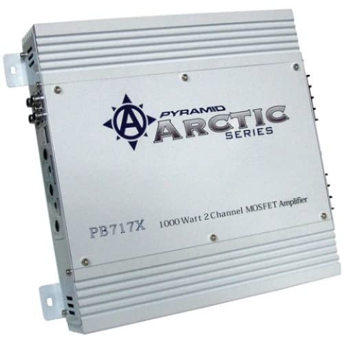

Hi I'm having trouble installing subs in my 01 vw gti. Sorry I'm new at car audio. //content.invisioncic.com/y282845/emoticons/confused.gif.e820e0216602db4765798ac39d28caa9.gif
The light on the amp turns on and everything i just cant get any sound to come out of the subs.
I have the stock double din monsoon headunit. I have this amp:
And 2 rockford fosgate 15 inch subs in a box with a red wire and black wire connectors in the back.
I have this converter
In the back where my stock amp is I spliced 4 wires and connected them to the converter and ran a rca cable from that to the amp(thers a low in and a output which one should i plug them into?). in the back of the amp it says speaker with right and left connectors, i plugged the sub wires into here. under the connectors it says bridged idk if that means anything.
Sorry im just really confused.//content.invisioncic.com/y282845/emoticons/confused.gif.e820e0216602db4765798ac39d28caa9.gif
That is a hi lev to low lev converter. You hook it in to the output of the rear speakers if you want a sub. + to + and - to - thats it. All it does is convert your line outs to RCA.
Also when you can afford it get a better amp. :)
Don't worry about ribbing about your gear. We all started somewhere.
You should be able to go to the manufacturers website to download an owners manual if you don't already have one.
