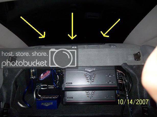

i have a charger and the fix to this is easy. get a ur rear deck ported. i have mine ported between the 6x9's. u cant tell its there from the inside cuz its has a screen over it but if u looked from inside the trunk, u would see a rectanguler hole prolly 14x6 (im just guessing here) big.

also on another note when you cut your decklid your making another port if your not carfull you can change your tone and mess up your ride,if the box is close to the decklid you can get fluter,remeber you are now making a dual ported box the port in your box and the port in your decklid.
