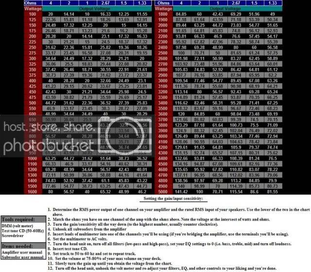

basically you just listen until it sounds different. you will hear the same sound then at one point it will change "pitch" slightly idk its hard to describe but just use a dmm and you will be fine.
^ Use that with a DMM
