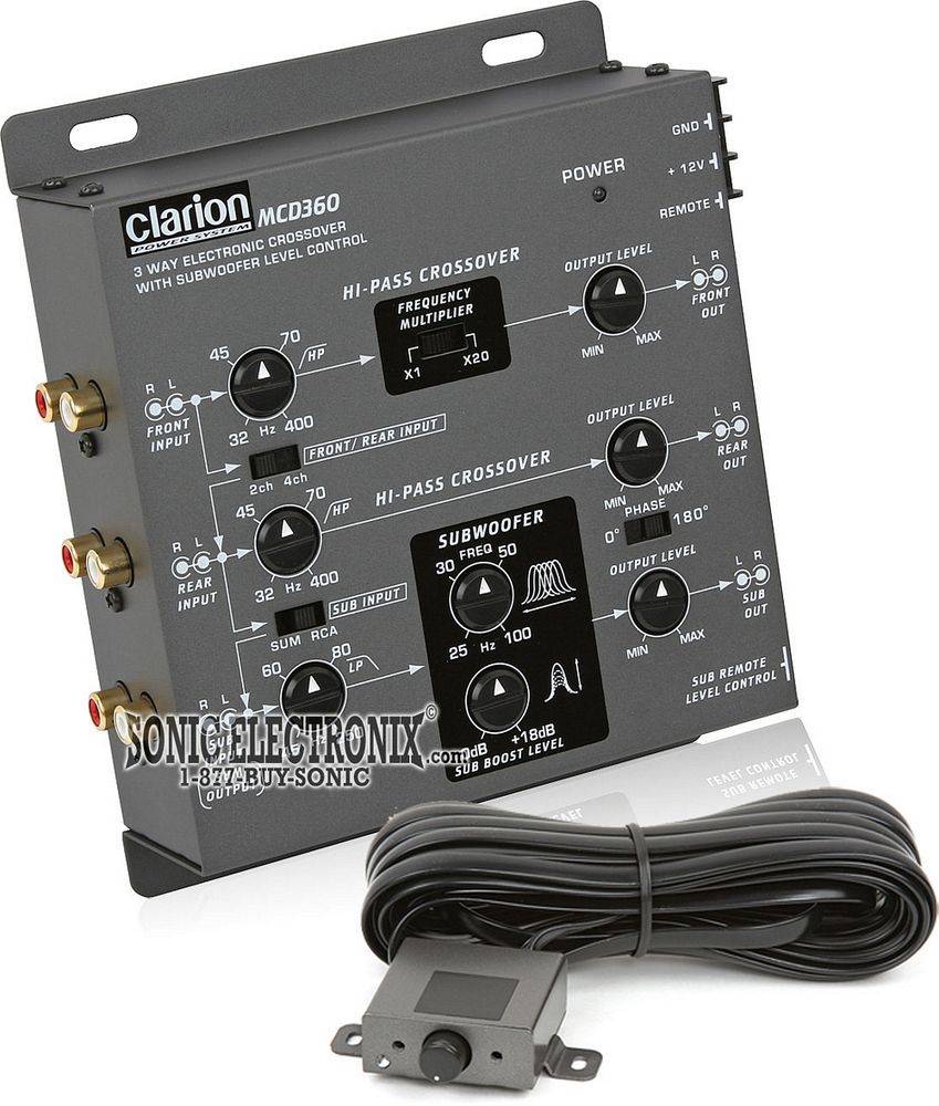

Ignore what I said above, as I believe I need a crossover. I am thinking to buy this:
Could you please tell me if I am right with this setup:
i) HU Pre Out > Front Input R/L
ii) Set the switch to 2CH (thus, this one RCA input is shared between the front and rear channels)
iii) Set the next switch to SUM (so the front input is this shared between the front, rear, and sub)
(so the Rear Input and Sub Input have nothing connected)
Then:
i) Front out > 4ch amp
ii) Rear out > 4ch amp
iii) Sub out > Mono block
Is this all right? So my system will only have a left and right channel, it will not have a front/rear (e.g. front left, rear left will output the exact same).
Lastly, for the sub, as I'm using a ported box I need a High Pass filter (my box is tuned to ~45Hz). Does this Clarion Crossover have a HP Filter - is this it:
Sorry to ask so much guys, I'm sure this will be my last set of questions.
Yes
Then:i) Front out > 4ch amp
yes, but you'll be able to adjust your front/rear independently using the output level adjustment of the x/o.
I don't see an infrasonic filter, but a lot of mono's have one. have you checked yours?
