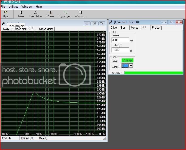

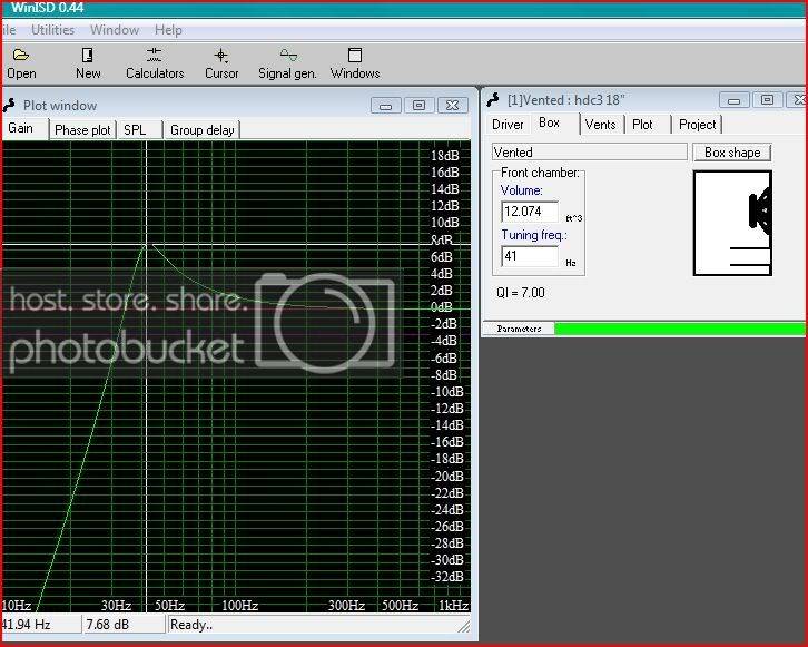

6 cf is cool but for high gain it takes more.just look here

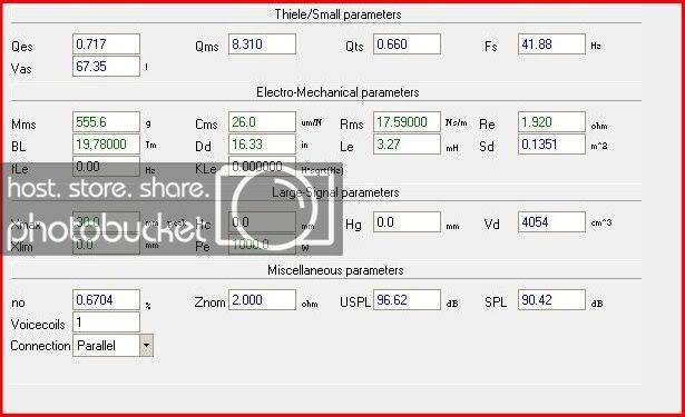

have you ever even pulled REAL Tsp's and built to them???
so the Fs on that 18 is 41 not 31? Is that what youre saying with your pictures? I was looking at getting two of these, giving them about 1750 RMS Each or 2200 each depending on how i do this. I only can afford to give them 5 cubes each, maybe a tad bit more. Was looking at tuning frequencies at 28, 30 and 38 Hz for a ten cube box. The 28 was flattest, the 30 looked good, and the 38 looked like it has a massive peak but would hammer at 43Hz
