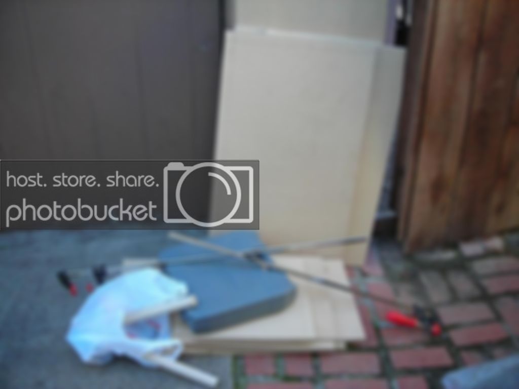

Pieces cut out, new clamps (i will be buying 2 more as i learned today, that you really cant have too many of them), my handy $20 ryobi drill, some drill bits, glue, and silicone

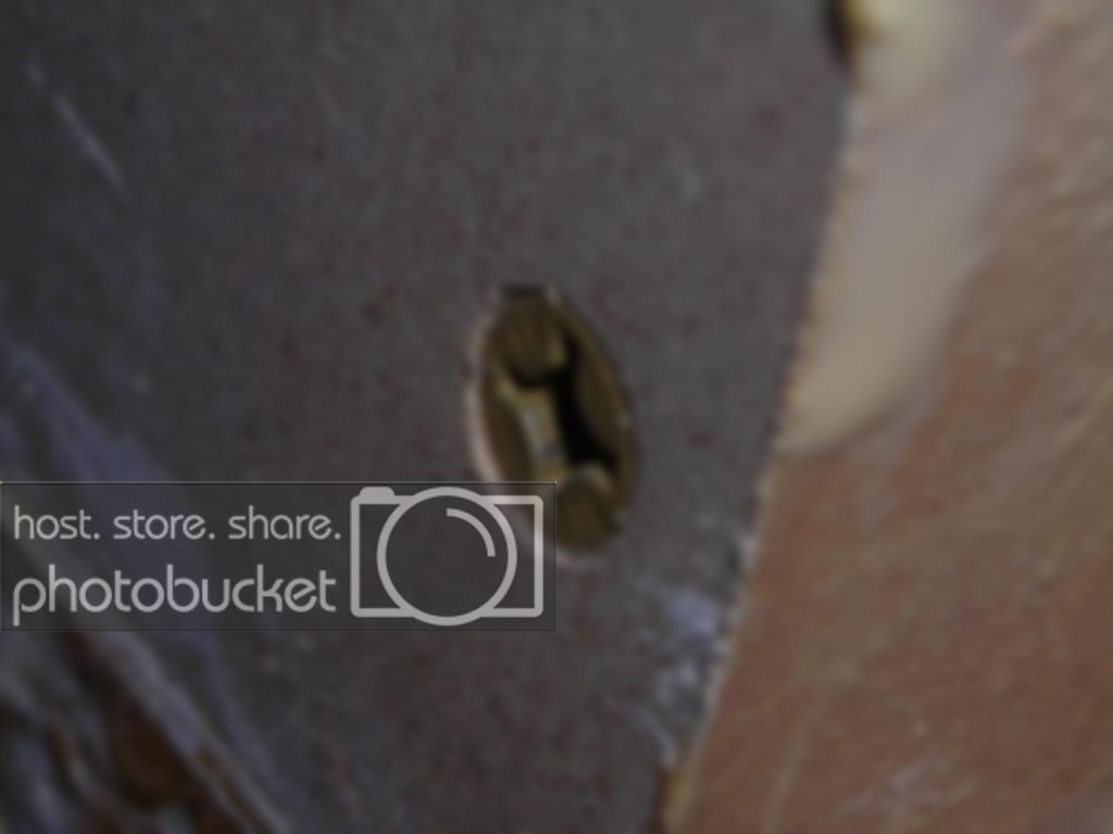

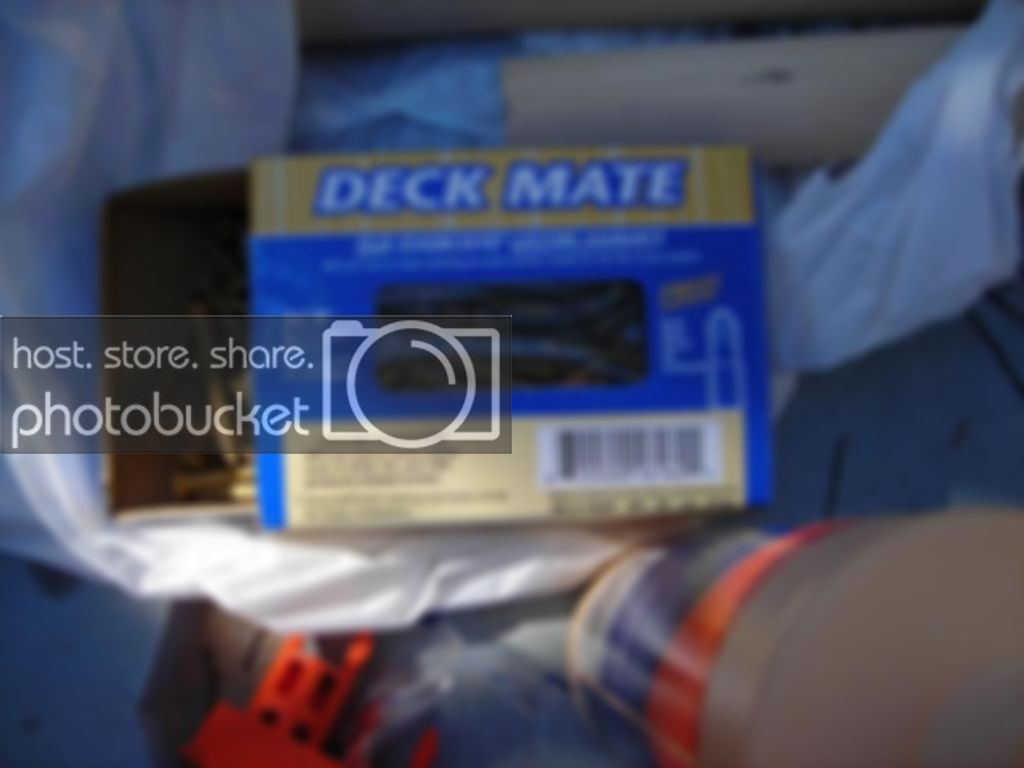

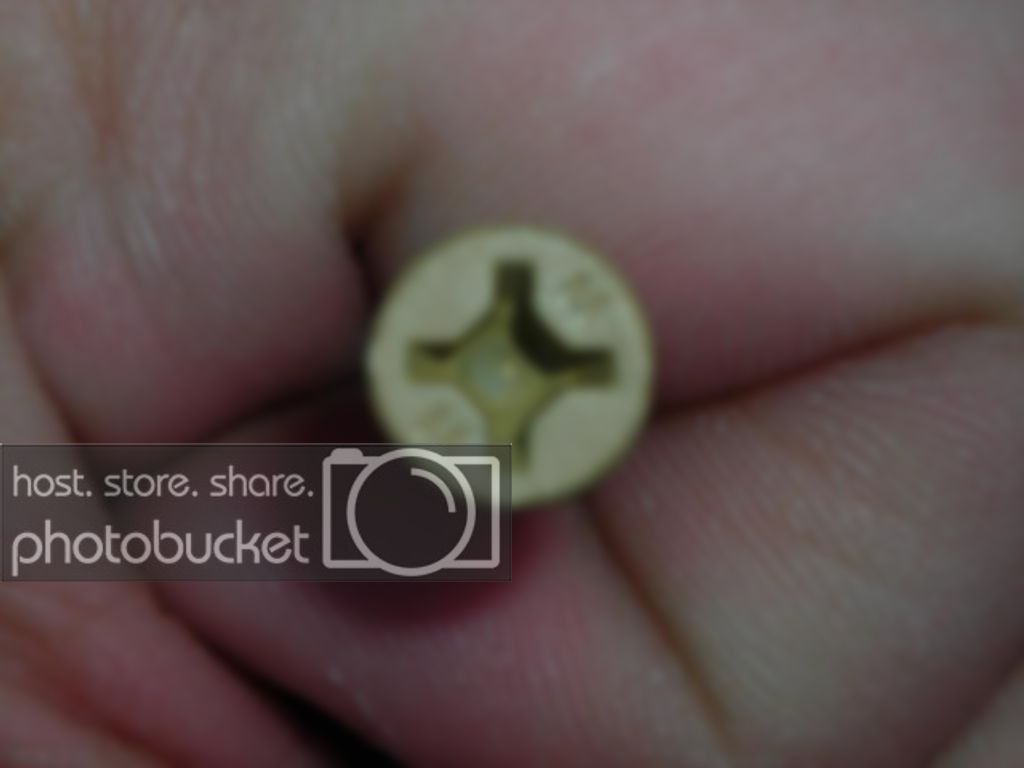

These are my screws of choice. i used to only use the 1 5/8" grip right screws (the grey ones in the dark grey box). i ran out of them and my gf's neighbor had these that come with their own little bit. this was on my last box build, and as you can see...i was happy enough with them to continue using them on the current build.

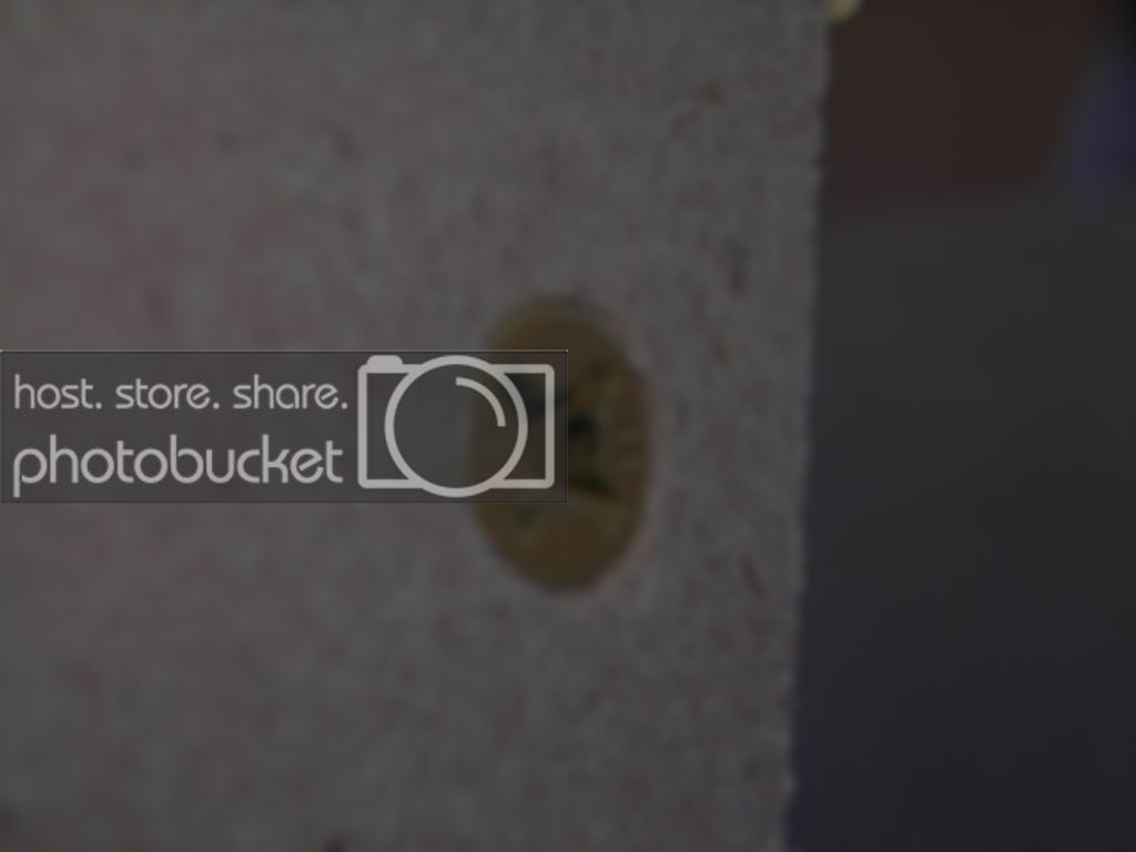

As you can see, the head is kind of a mix between an allen head, and a philips head. i have found that because of this unique head, they are almost impossible to strip out, AND you can counter sink them, without using an actual counter sink bit as the pictures show. And as mentioned before, each box comes with the special little bit to fit these screws.

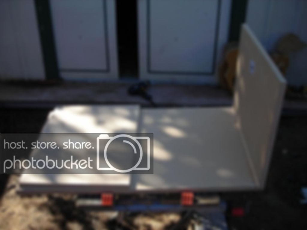

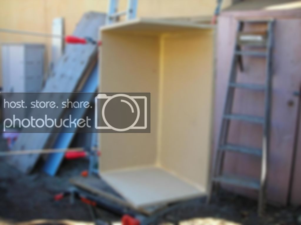

First side up

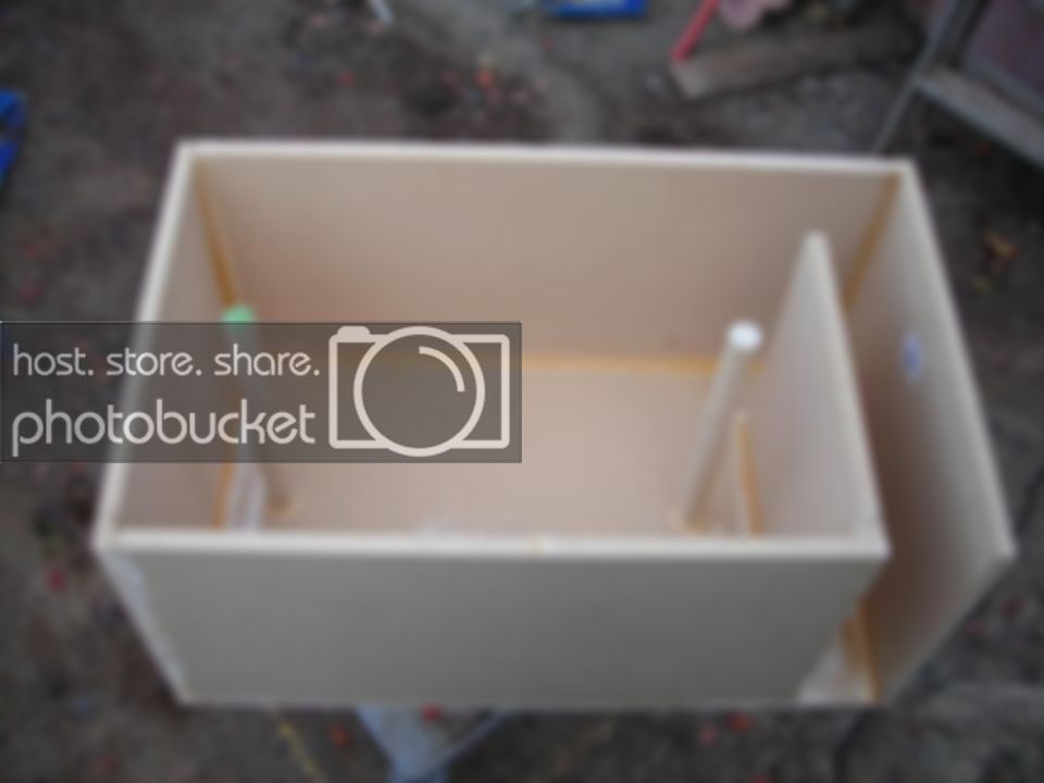

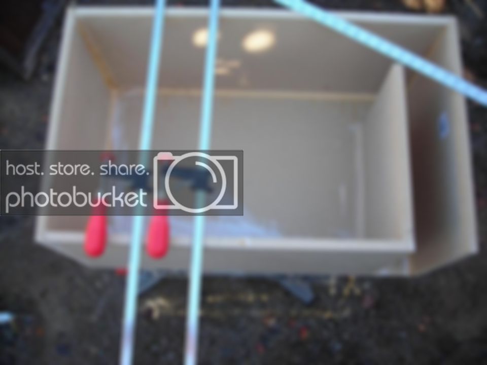

Second wall, and back panel glued and screwed

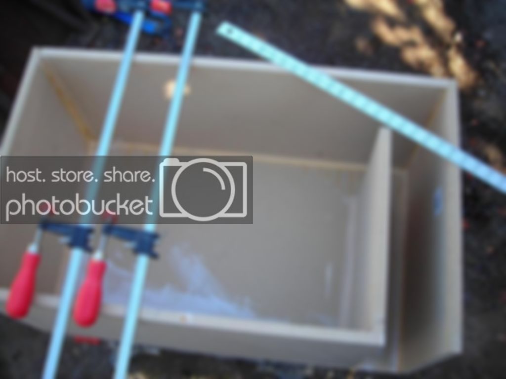

Port wall glued and screwed

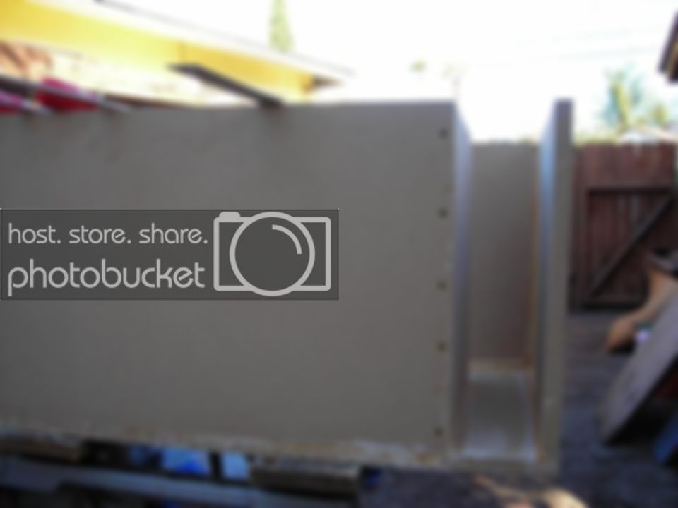

Dowels, marked/measured, glued and screwed

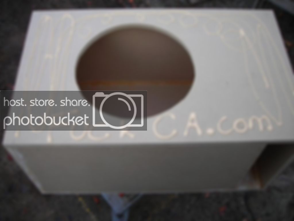

Sub cutout, plus a big you know what for CA.com until they fix the forbidden error and slowness of the site //content.invisioncic.com/y282845/emoticons/fyi.gif.9f1f679348da7204ce960cfc74bca8e0.gif....which also happens to be the glue for the double baffle (yes i added much more glue for good contact, i just took the picture when i just started)

Looks good. Nice build.
(Be careful putting those screws so close to the edge. Everytime I get as close as you got my MDG splits, but maybe it is the screws I use.)
Looks good. Nice build.(Be careful putting those screws so close to the edge. Everytime I get as close as you got my MDG splits, but maybe it is the screws I use.)
nope, its not the screws you use, its just being too close to the edge. i have done it on this build, as well as many others. sometimes, i just get to close and it does split. i guess it depends on how much time you feel like putting into the box. i just kinda go "eh, here seems good" and predrill that *****
