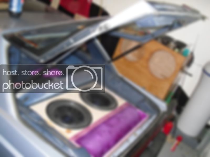

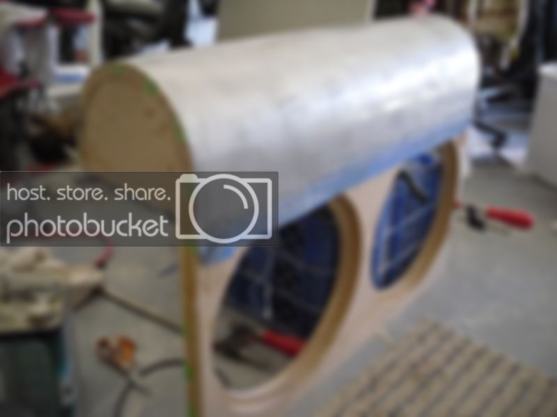

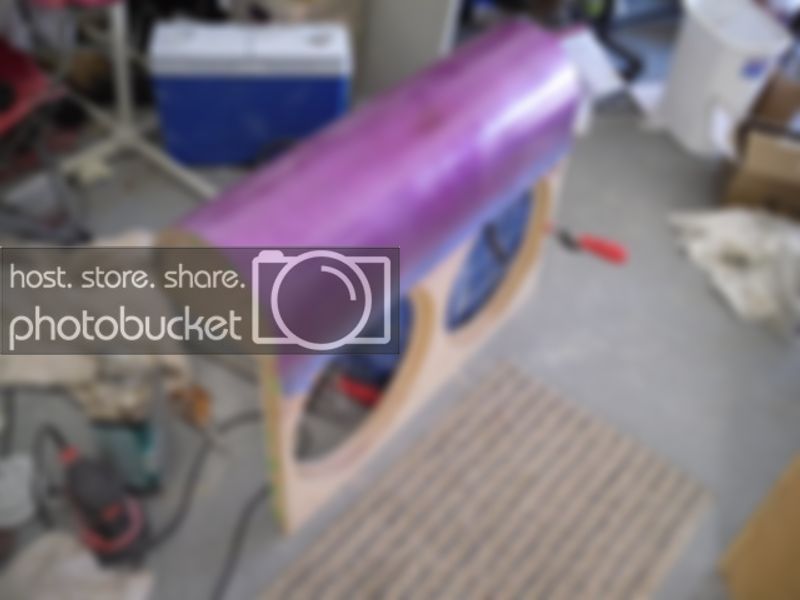

I aided with the design and some brute work- but most of this has been built by my GF who plans on doing 139.9s soon
"Lola"
Old Setup:
x2 Exlipse Aluminum 12s
3cuft @45hz
bxi606
8ga wiring w/stock bat
New Setup:
x2 DC lvl 4 15s
4+cuft @40hz
bxi1606 (looking to upgrade)
1/0ga wiring w/redtop w/big 3 upgrade
On to the PIX
-Drew

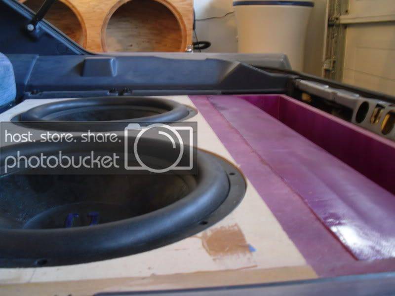

Its actually Tuned Pretty high- for a good sound on alternative and kinda pop style stuff.
only 5cuft under the storage line, 4cuft with the port so not much space to tune low unfortunately

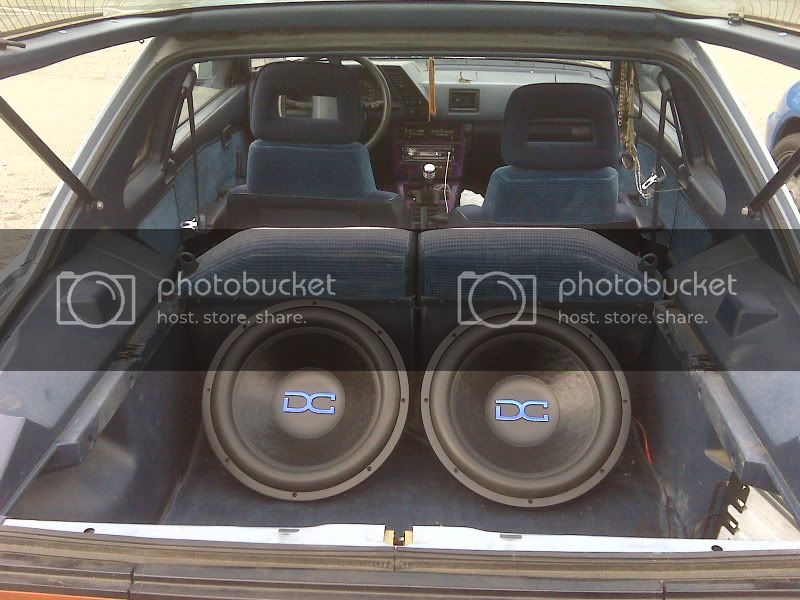

that's only expected to hit 140? I've never been metered or heard anything really loud. Its a LEGIT question....
With that power i'd say 140-142 is doable no problem in the hatch. The tuning... eh but otherwise yum.
Almost tops my gf's 4 12s :p.. I need to post up that buildlog //content.invisioncic.com/y282845/emoticons/crap.gif.7f4dd41e3e9b23fbd170a1ee6f65cecc.gif
No, I'm sure he expects it to be quite a bit louder than 140. He said this car will be in the 130-139.9 bass race, where competitors play music for 30 seconds and the goal is to get the highest average possible without exceeding 139.9 dB. Thus, an average of 139.9 dB over 30 seconds is a perfect score.
