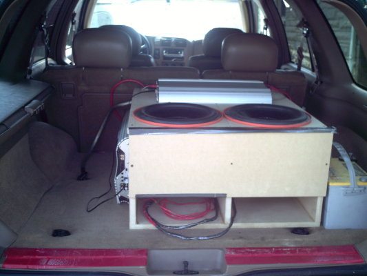

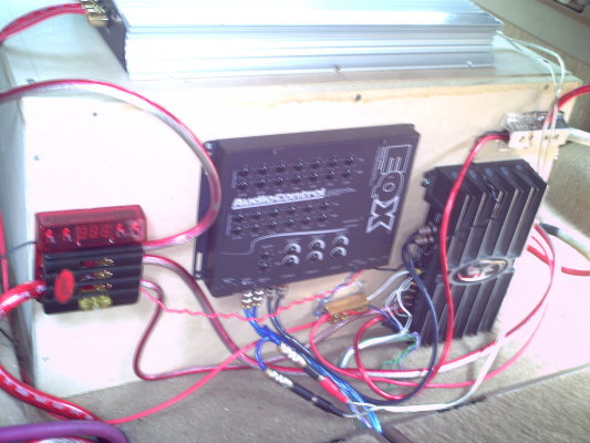

Well i got bored today and built a new box. Heres some pics.
Now thats a PHAT install right there.
i still need to resin the box and sand some corners.

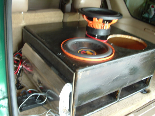

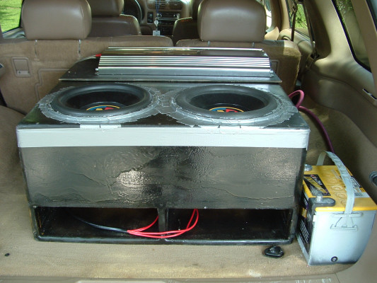

My old box:
With the old box my loudest was a 150.8 on the tl. hopefully the new box is a little louder. Also am waiting on a Z1 //content.invisioncic.com/y282845/emoticons/wink.gif.608e3ea05f1a9f98611af0861652f8fb.gif
SPL install all the way //content.invisioncic.com/y282845/emoticons/smile.gif.1ebc41e1811405b213edfc4622c41e27.gif
Missing duct tape on the new one, though //content.invisioncic.com/y282845/emoticons/wink.gif.608e3ea05f1a9f98611af0861652f8fb.gif
the last one was almost 6 cubes (3 a piece) the new one is 2 cubes a piece port is 4" x11.75 and 13 deep. but I need to test with the length of the port. I havent glued the port in yet until i test the length. the ports are identical.
