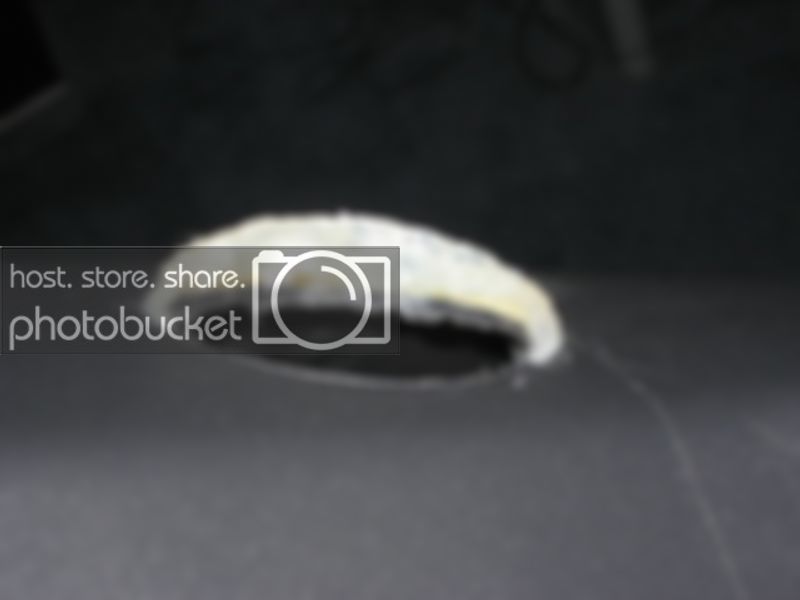

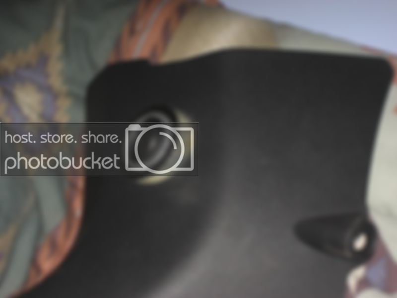

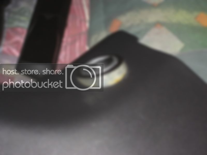

well today i had the bright idea pop into my head of using hot glue to build up sort of like a pod for my tweeter on my left kick panel. the right tweeter can easily be made on axis within the range of adjustment that the swivel allows. the left side however, was pretty close before but now i should be able to easily get the left side perfectly on axis as well.
i asked a few crafty women that i knew if they had ever seen black hot glue sticks, but none of them knew. so i figured i'd try it with the regular clear sticks. i will eventually, when it warms up clean them up a bit and spray a few coats of flat black paint on them. but even now, when mounted it should be pretty hard to see anyway.

how structurally stable does it need to be? it works fine, was practically free for me, and looks fine. i'll just paint the glue black and call it a day. i think i still wanna build it up just a tad more though as well.

well after a couple days if listening i'm gonna have to say it worked out pretty **** well. this little fix wit the help of some T/A really fixed my problems. the left side sounds a lot closer to how the right side sounds. it sounds just as loud and detailed now from the left side as it does the right side. cymbal splashes and such sound very centered and high now when coming from both sides.

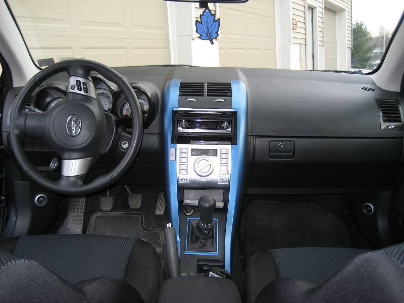

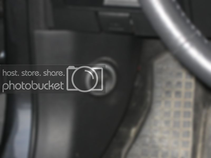

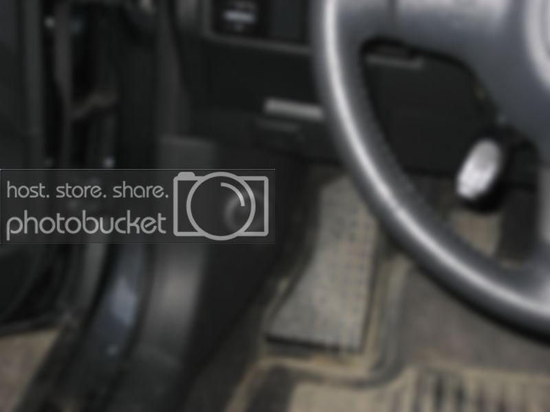

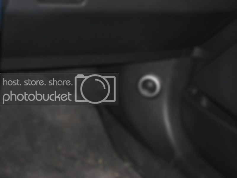

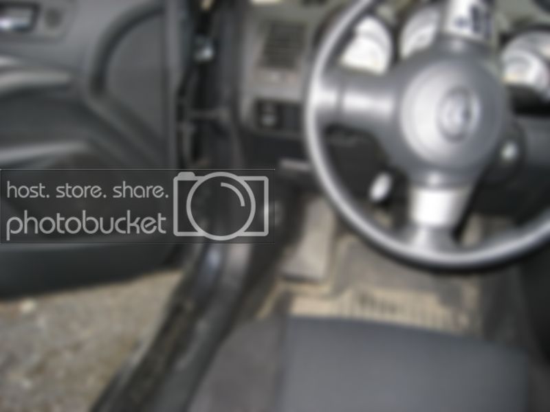

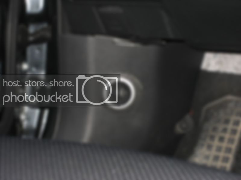

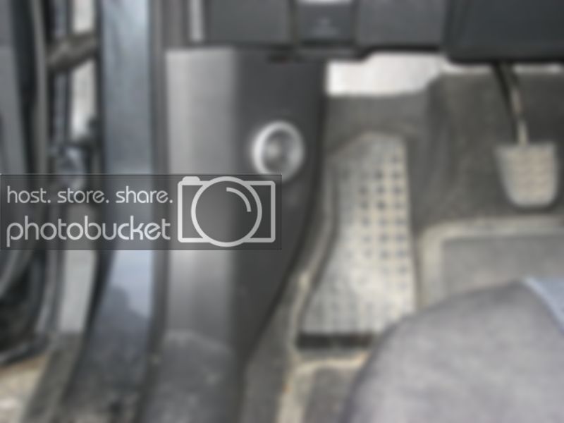

GOT SOME PICS with them all mounted!! i know everybody likes pictures!
some of these were taken with the camera at the headrest so you can see the angle as i am seeing it from the drivers seat.
