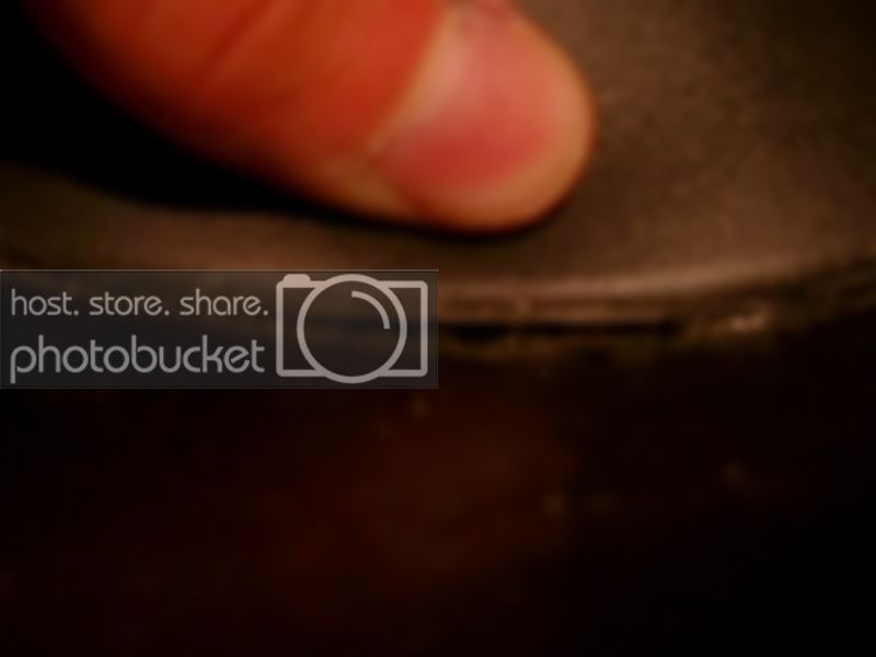

Gap in the dustcap
hot glue, epoxy, maybe silcone..
i dont have the slightest idea.. i just have heard of some people using that to put their dustcaps back on the cone
i could be wrong though
i think ill just use epoxy its really small
Epoxy will work. I'd use accelerated superglue (what was being referred to above as "CA" glue), with the spray "zip kicker" if it were me, but epoxy will work just fine. That's what I would have used, before the zip kicker superglue was available, back in the day...
