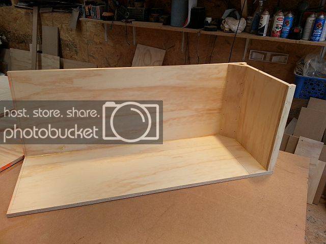

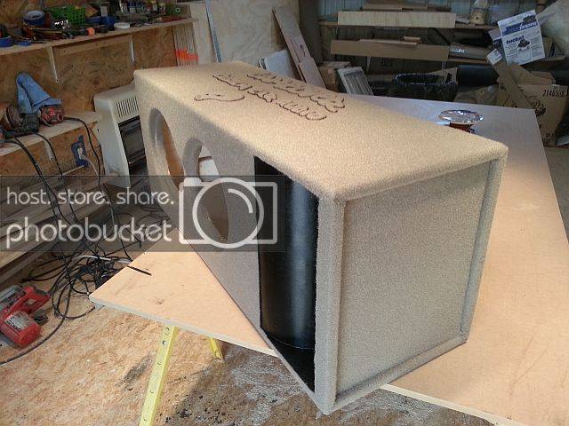

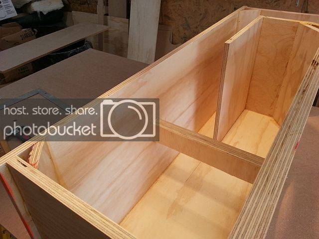

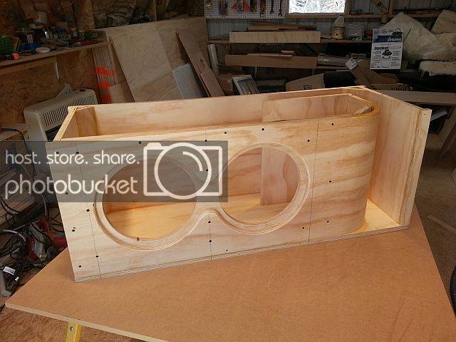

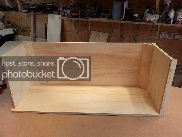

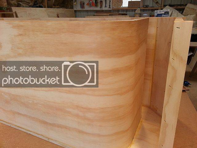

This is for GameOver Custom Car Audio's personal ride......Pair of IA Lethal Injection 12s.....4.5cf net @ 32 hz......Arauco...flush mount...kerf port.....Logos....tan carpeting.....
Nice box but why put "game over custom car audio" on the box if the "custom car audio" company didnt build the box //content.invisioncic.com/y282845/emoticons/wow.gif.23d729408e9177caa2a0ed6a2ba6588e.gif
Think they should all have your company name on them.
That is what the customer wanted....He owns the business but doesn't build enclosures I would guess.........Yep I need Starr Mountain Sound on every one that leaves here...LMAO....good advertisement
