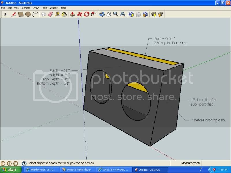

..im sure you can manage atleast 4.5 cubes for each one after port and bracing.. Especially in a wall. I measured out 13 cubes before any displacements..not counting a doubled front baffle..but i guess youd prob need triple or double on multiple sides.
I could get that space, but then my seat would move forward past my comfort point. I am 6'3'' tall and need all the space I can get. Trust me, I want them in!
Well since there is no real interest I am going to install these in less than ideal airspace and see what happens!
I have a design thats a wedge that goes halfway up the rear window..Its 13.1 cubes after sub and port displacement for 2x 18s but before any braces or double baffle. But it would even make me a TAD uncomfortable..but im like 6 foot. Not sure if the port being that **** long would be a problem but i got enuff port area.
Yeah, that's one of the designs I was working with except the top of the box I designed was 14" deep. I don't have stock seats in my truck, so my space is a little smaller.
