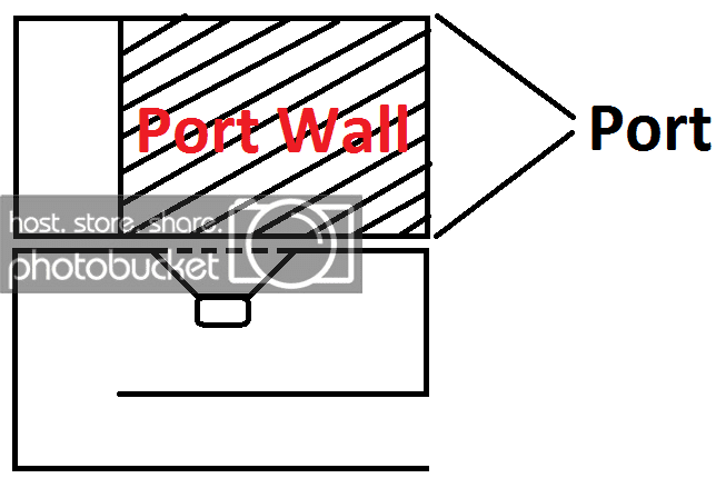

Here is my original enclosure, built for 2 IDQv3's. It is approximately 5.35 cu. ft. and it's port tuned to some higher frequency around 42 hz or so. It was built by a builder here in De. I wanted to focus on SQ, so he tuned it high. Well, I don't like it. First of all, I blew one woofer. Rookie mistake. Also, for me, sealed just does a better job of SQ, so I had him seal the port, and put a new top piece on for 1 15" instead of 2 12".

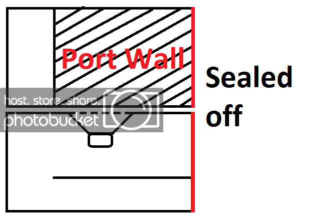

So, here we have the current enclosure. It has been sealed off, and now accommodates a single 15" woofer. I've decided to go with a single 10 in a custom enclosure for my SQ, but now I wan't this 15" to be LOUD and LOW.
I will have 2 separate systems incorporated in my vehicle. One single 10" for SQ, and 1 15" for SPL, controlled each by their own switches on the dash. So, I want to port this thing again, but I also want to decrease the internal volume.

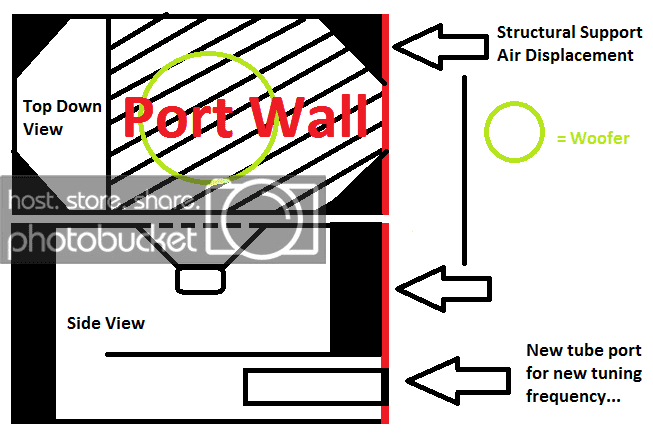

My plan is to do this....
I want to put in place structural triangle braces, blocks of wood cut at a 45 degree angle. This should lower the box volume to my specifications. Also, I want to install a series of tube ports to create a new tuning frequency around 32hz.
Is this feasible? From what I've read, these structural braces are fine, but my main worry is the port within a port. Is this going to cause any issues? Can I consider the old port wall a structural brace? I'm wanting an SMD 15" or a AA Mayhem 15", and my reasoning is that this old port wall can serve as extra bracing..

The old port is the only issue here. If you tear it out, you'll be fine, and I'm sure we can find something that would work for your box. We need to know what the net internal volume of your box would be with the port out, though.
Great. I was thinking the port might be an issue, but I just didn't know. I'll have to see if I can remove the port. As far as the NET volume, that would be accounting for the woofer displacement?
I will measure the port and then subtract its area from the total. The subwoofer dimension is the only thing I'm unsure about when it comes to net vs gross volume.
Thank you. You've clarified what is feasible and what is not.
These are opinions and everyone has one. Just do it and then you will know. I see no problems with what you want to do except added obstruction and turbulence to the path of the new port. You might not even hear a difference with or without the old port panel there. However, you could beat the old panel out.
When I was referring to net, I guess I should have just said gross. I just mean the gross volume after you take the port out. When you're trying to calculate the actual chamber's volume when designing a box, though, net usually refers to the chamber, ie., after accounting for the port and sub displacement.
If the box is put together simply, meaning no sides are extended past each other, and there isn't a double baffle, no 45s or other bracing, then to make it easier on yourself, just measure the external dimensions and I(or whoever posts before me) can calculate the gross internal volume.
I'm definitely going to take my mini sledge to that port wall. Hopefully it plays nicely.
Gotcha. I don't have the box with me now, but the height is 17", depth is 17", width is between 39.75" and 40". According to RF Woofer Box Wizard, I'm looking at ~5.32 - 5.35 cu. ft. total gross volume. I'm not sure if that 1/4 inch makes too much of a difference... I just know that the width wasn't quite 40", but within a quarter inch.
