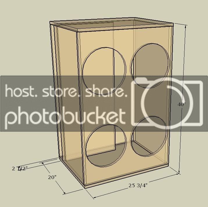

I have designed a couple 4 sub boxes for 12's
Here are some examples. IT all about what your targeting, I asssume SPL. Shot me your max dimensions and I'll throw something together.
Here a CRX style to give you an idea.

I'm looking for mostly SPL with this new setup. I can care less what it hits on the meter, as long as it's loud as possible to the ear. Maybe tuned to around 30-35hz.
