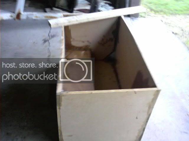

welll between last night a little bit and this morning i got some more work done

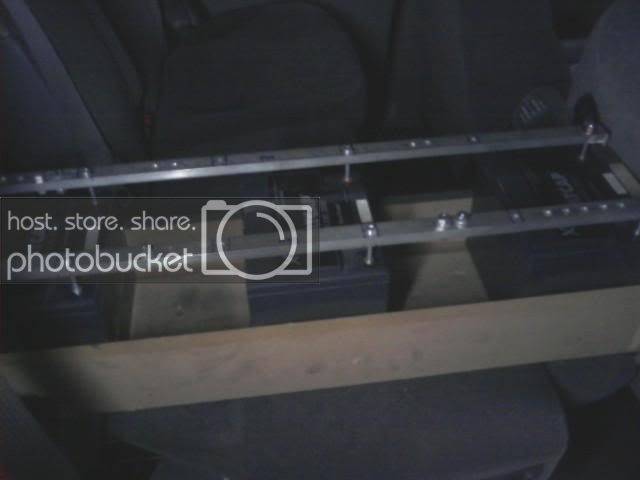

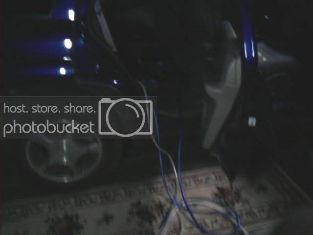

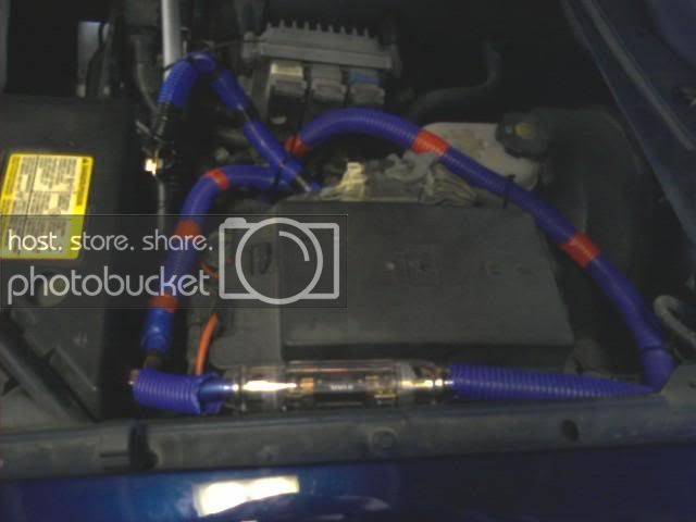

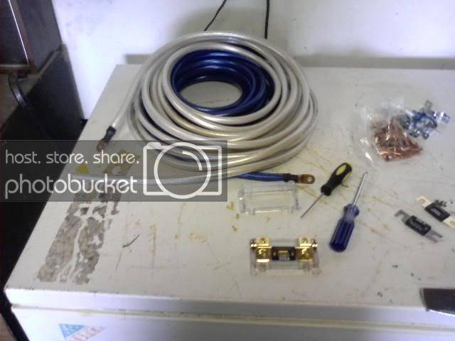

Ran some wire
So messy!

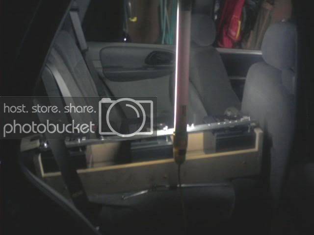

all cleaned up now....lets put some batts in
Now lets get this **** box finished

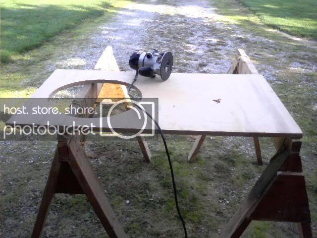

Thank god for routers //content.invisioncic.com/y282845/emoticons/smile.gif.1ebc41e1811405b213edfc4622c41e27.gif

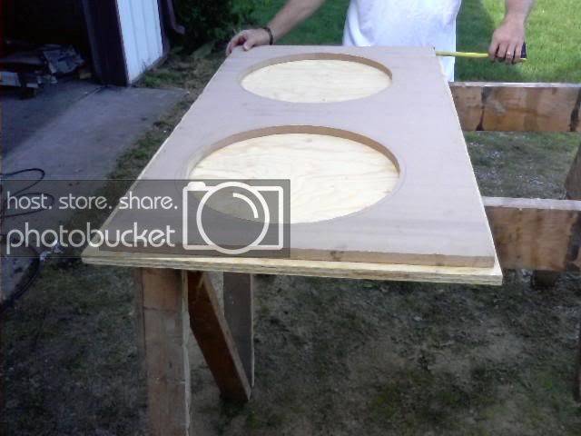

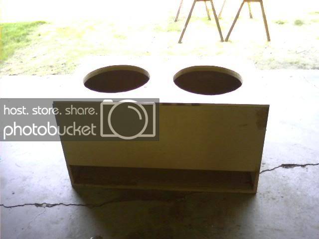

now cuttin my other baffle

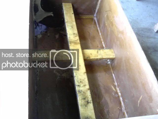

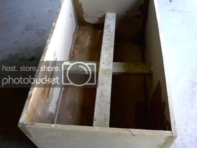

not to tha bracing...going with a t-brace
All glassed too

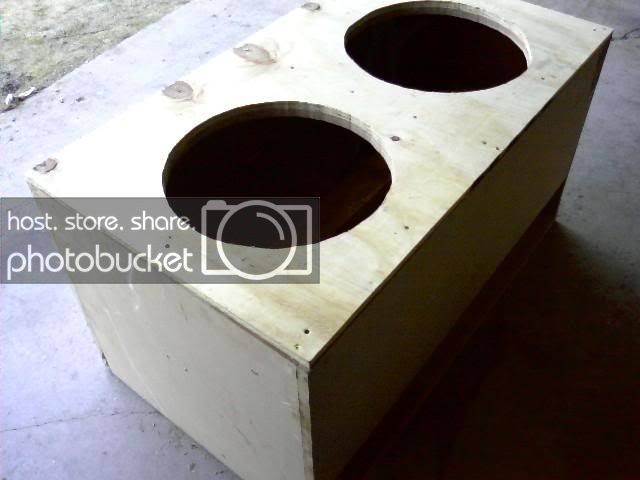

top put on and all finished //content.invisioncic.com/y282845/emoticons/biggrin.gif.d71a5d36fcbab170f2364c9f2e3946cb.gif
planning on bracing the baffle? with all that force going even a double baffle could flex, a simple 2x4 under the baffle running between the 2 sub cutouts with the 2inch side touching the baffle would probably be sufficient and really stiffen up that baffle
Not sure yet if im gonna keep the double and leave it or brace it or put a third baffle on :S well see lol
