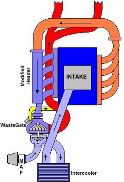

Please excuse my rudamentary design criteria, I lack the petty cash($10,000) to pick up a copy of AutoDesk Inventor or something of the like for designing. I'll make some official designs when I return to school after spring break. The exhuast is already routed to the pas side, so I think I will do as I saw somweone esle do. Keep the drivers side manifold the way it is and just cut off the exhaust and fab up a pipe that will connect to the custom ps manifold. I will be doing some research into airflow charicteristics, as I do not want to choke the turbo with a shitty exhaust mani design.
*Img rights of the creator. Image was linked off of the turbo bible.

the budget turbo build usually includes some corvette headers turned upside down...keeps you from having to buy/fab some tubular manifolds...
If I go twins, then I will look into that. If I stick with a single, then I will go ahead with my current plan. As for fabrication, I actually want to fabricate the parts. Some may hate fab but I love it. Maybe I'm just different.//content.invisioncic.com/y282845/emoticons/confused.gif.e820e0216602db4765798ac39d28caa9.gif
you can just run a cross over pipe from the drivers side mainfold to the passenger...id get some pics, but im lazy.
Got ya covered :p
Tis my plan, but it will require fab to create the PS/ final collector. So either way, I have to fab something. Which is cool for me //content.invisioncic.com/y282845/emoticons/smile.gif.1ebc41e1811405b213edfc4622c41e27.gif
