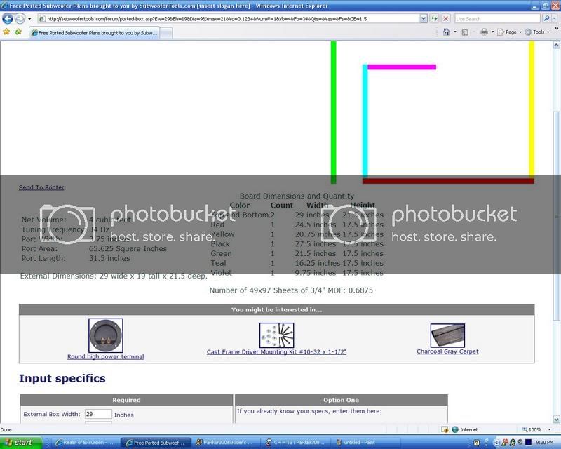

Here is what my box I am bulidin for a 15" type R is like.
My question is if I do a flare port with a 3.5" radius how much length do I need to add to the port to keep the tuning at 34hz and which color do I add this to in the diagram? The voilet correct? Thanks.
