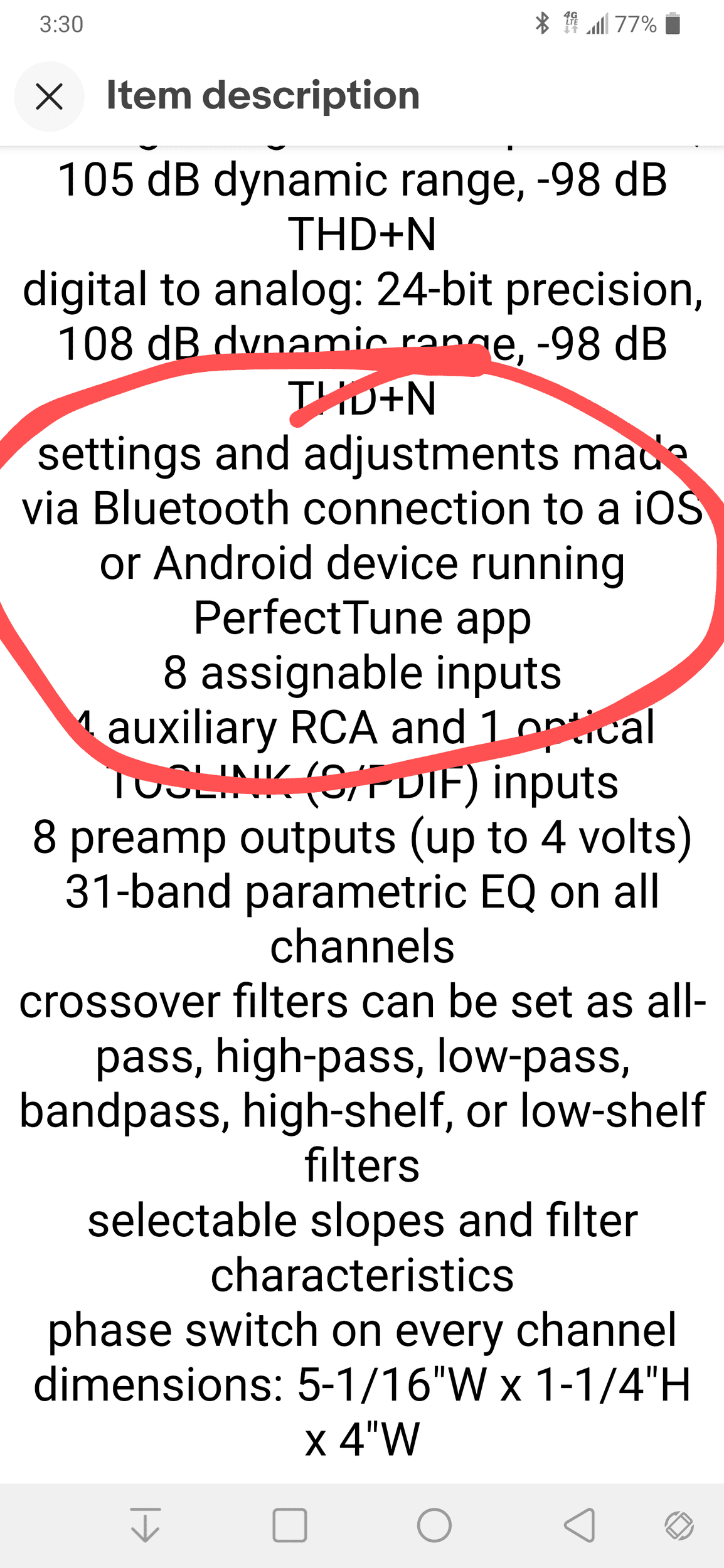

One last question...will the digital signal processor, or any of these items, come with a phone app? I assume these will be hidden and I'll just be looking at the same display I see now?
According to this, you can download Rockford Fosgate Perfect Tune from Appstore/Appleplay.
I think the DSP will be near the amps. The radio display will not change.
