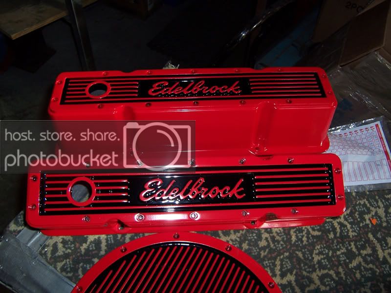

First time powder coating
Very nice job man.

sorry fellas no updates, i did a bunch of research today tho! I didnt get back to the house until too late to go get red powder. Tomorrow i hope to have at least one valve cover done silky smooth. Ill also b modding my sprayer tomorrow so that i dont have any more clumping like on the intake cover.
Fail. I'll post a pic of some I did for a buddy then :p
oh sure, make me look bad jason thats fine, ya know yesterday i thought u were a good guy helpin me out with all my questions n what not, now u go n do this and make me look like a red headed step child.
JK those are gorgeous. lots of masking i assume?
