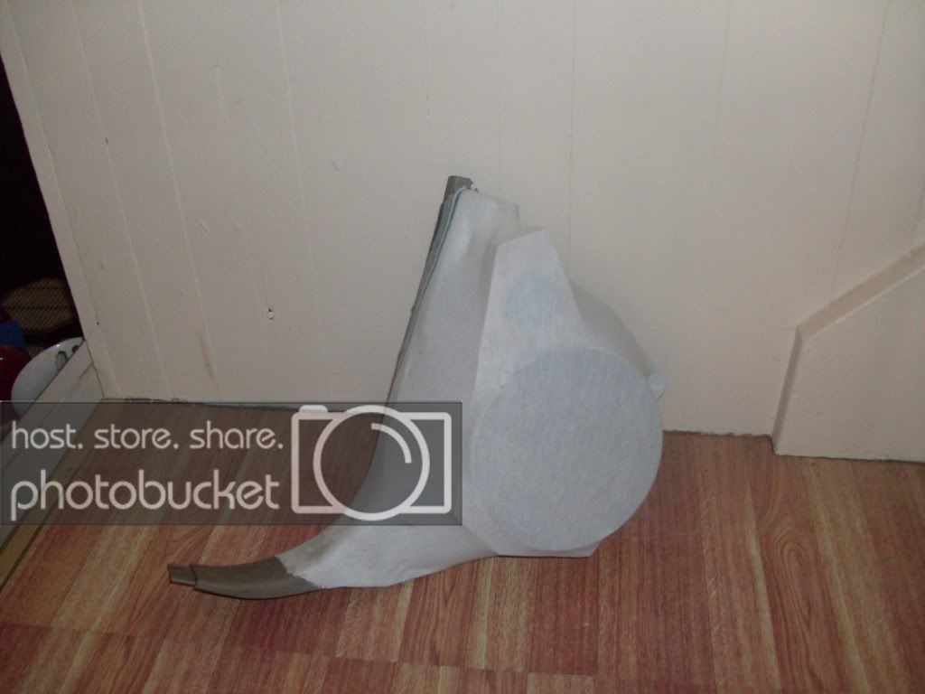

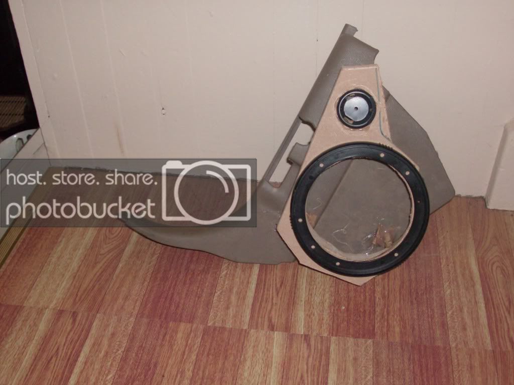

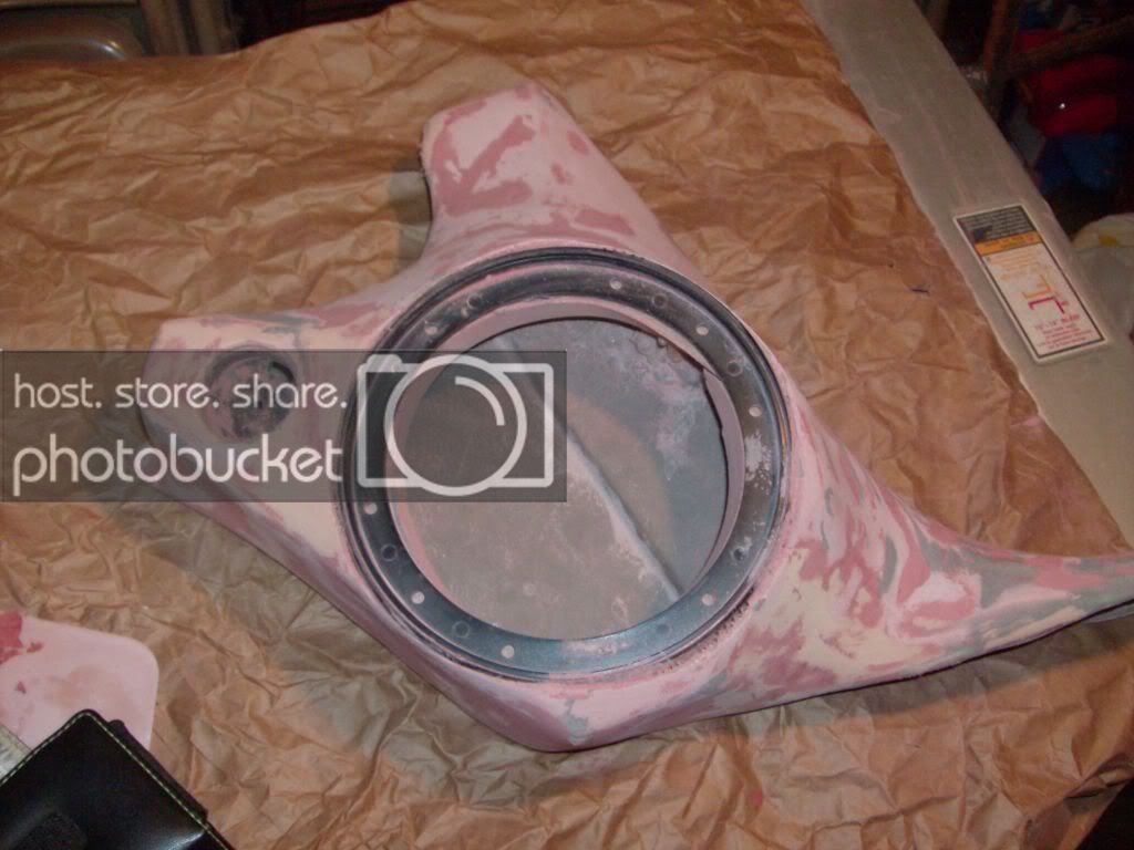

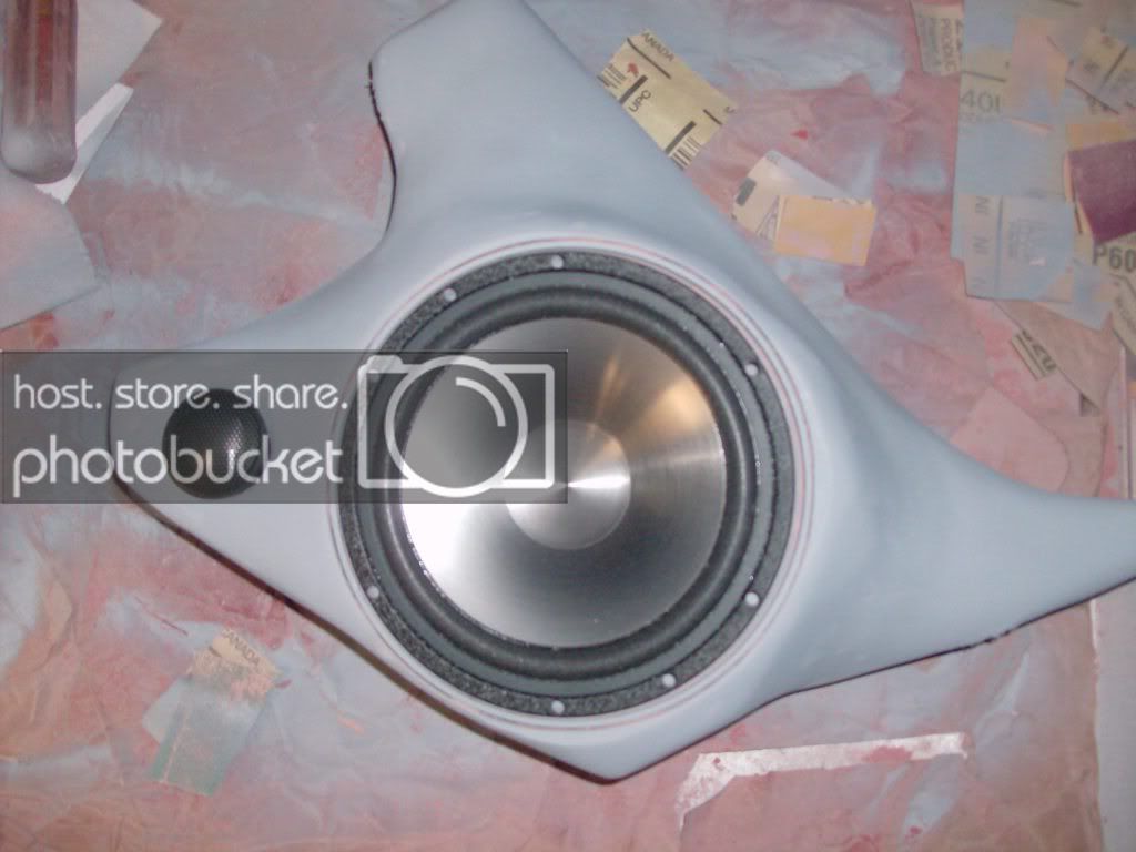

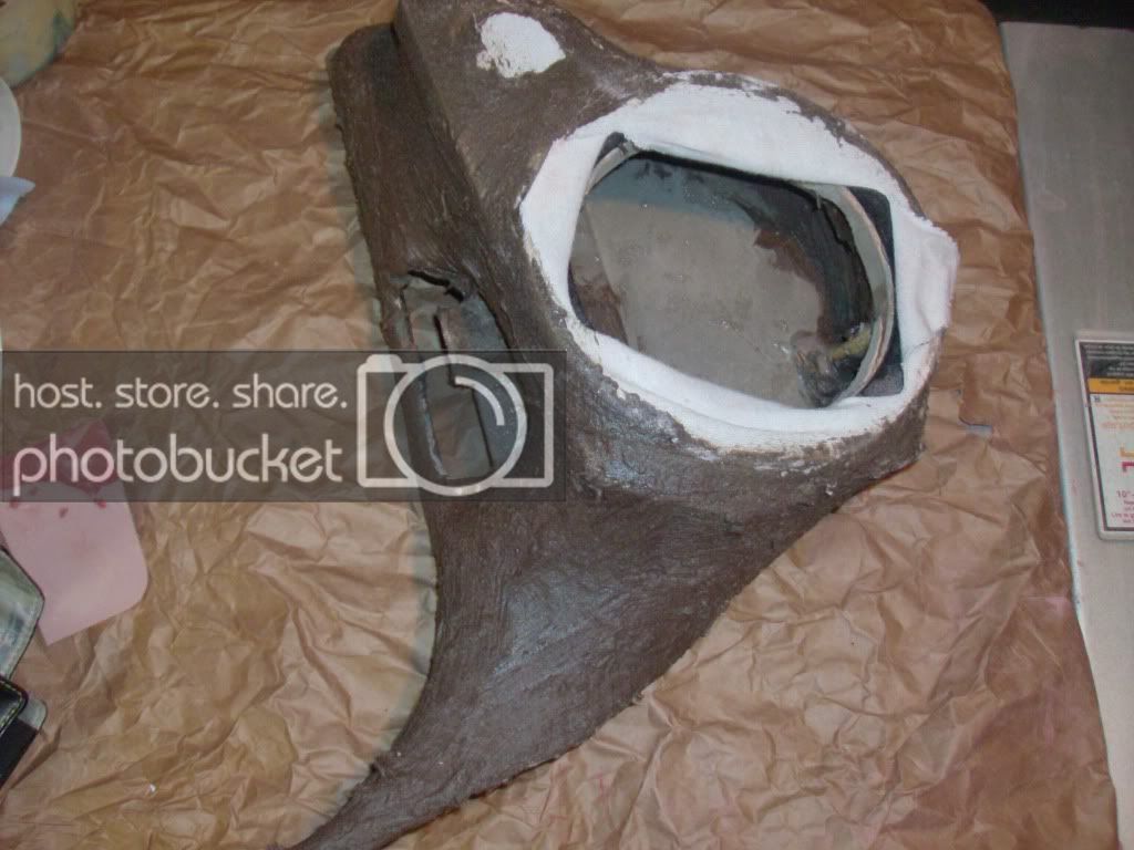

So i decided to try my luck in constructing some kicks. I ended getting the bondo brand jelly resin by accident. Ended up doing one coat on the outside and one coat on the inside. knocked it down with some 40 grit. threw some dynagold kocked it down with 120 grit. I primed it to be easier to see where I needed the filler then hit it with 320 gritand primed again. Going to coat it with some SEm textured paint and then with their light gray to match my interior.
haahaa no, NOT trying to deceive you guys.. both driver and pass. side were done the same way but pics of the steps on the pass side didnt show up on memory card. so I used pics of process from both driver and pass side....
