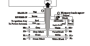

For starters here is the wiring diagram for your stereo..
DO NOT cut any of the wires except for the following.
Gray/gray black, Green/green black, Violet/violet black, and White/white black are your speaker wires.
The ONLY other wire you will cut and splice into is the power antenna lead wire, i don't know what color but it should have a diode wired into it, this wire will also function as the turn-on circuit for the amplifier.
