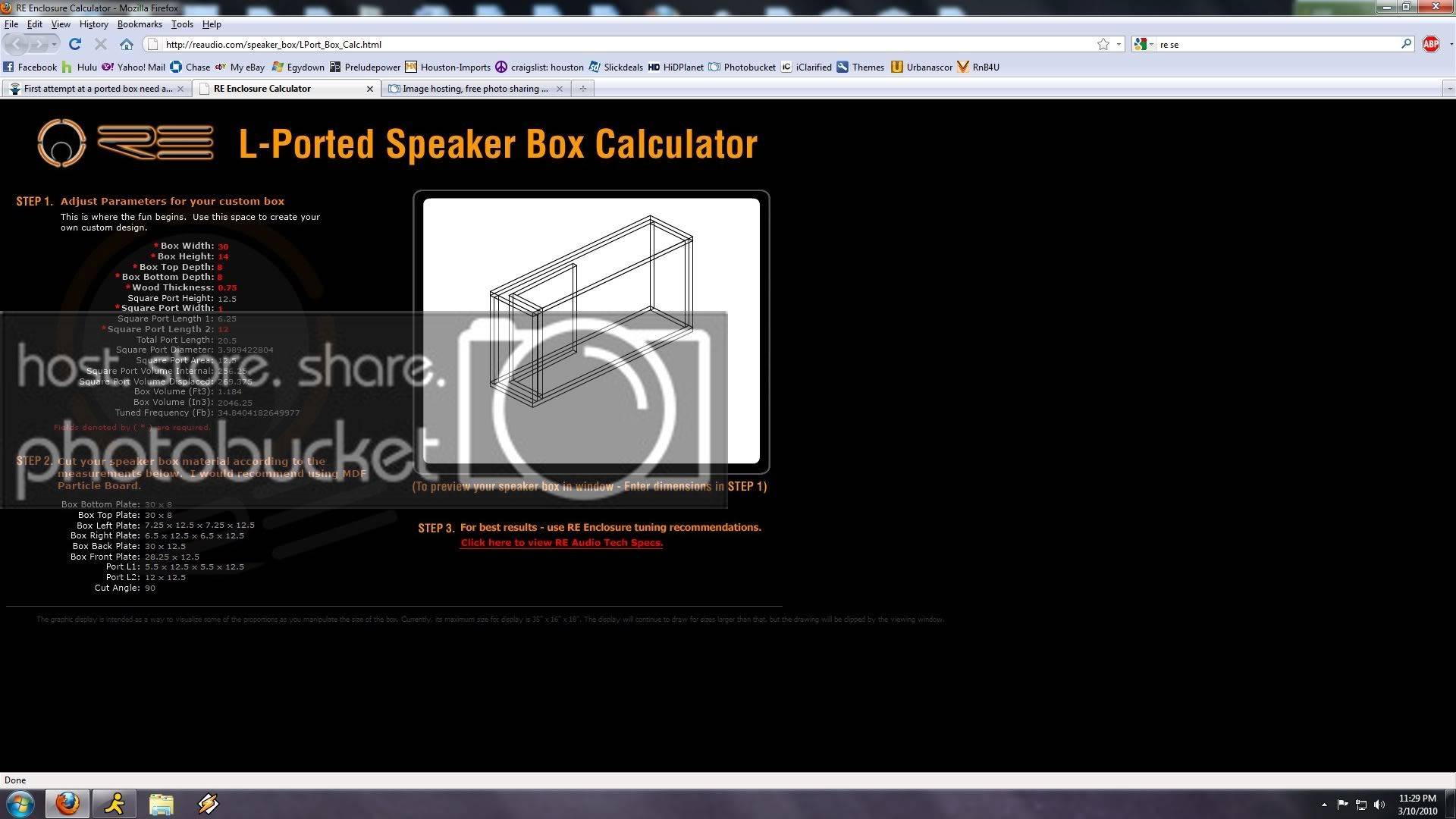

I used a caluclator on the measurements and it comes out to be 1.043 cubic feet and the recommended from their website is compact 1.0 and Optimal 1.25 cubic feet.
http://www.bcae1.com/spboxnew2.htm

I entered my measurements that i was happy with and i came up with this sizing in the Re website. I have a question will a 1 in ported hole big enough? All the data that inputted into the calculator seems to be correctly paired up with the RE SE 10". It should to good right since i am using their subwoofer.

What do you mean tune it to 24 on the calculator it says 34.84 Hz. Is this correct? On the Re Se Subwoofer 10" compact is 1.0@35Hz and Optimal is 1.25@34Hz.
1 in port is definitely big enough, and from your screen shot everything looks good. But as I mentioned earlier its going to be hard to build your own box especially one with an "L" vent. I'm not saying it can't be done but its pretty tough to build one and keep it air tight without leaks. But as far I can tell everything from the screen shot looks good. Use 3/4 mdf and follow the specs outlined. If you decide not build your own box here are some reliable pre-fab enclosure manufacturers :
