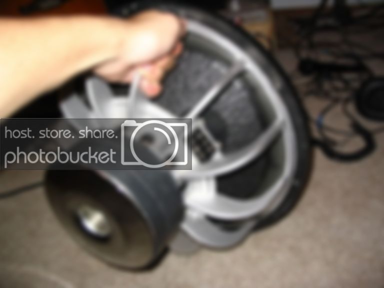

Box for 15 SX, 4cuft 32Hz. Heres the sub going in it with the amp powering it-

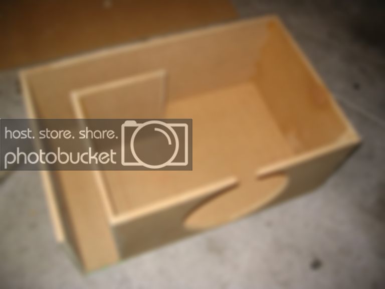

It was basically built into two different parts. This one-
and this one-
I put them together to make this //content.invisioncic.com/y282845/emoticons/biggrin.gif.d71a5d36fcbab170f2364c9f2e3946cb.gif -

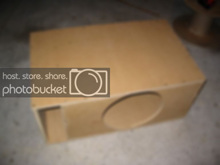

With the top on-

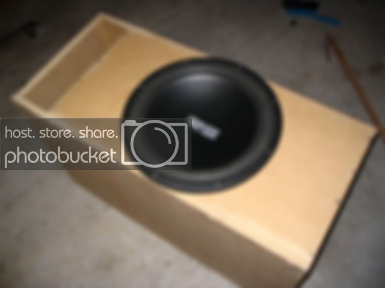

And with the sub in it-

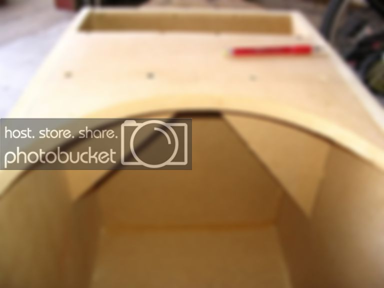

You should of had the baffle sit on top of the sides, instead of flush.
Take a look at your second picture from the bottom. What I'd do is lay a piece of MDF flat on that bottom piece, and see if the basket on the sub will clear that hole with that piece right there. If it does, screw down that piece to the floor, then screw the woofer into the baffle with longer screws- 2" drywalls should suffice, that way it catches into that extra piece and provides more support. I wouldn't leave it the way it is- other then that, construction looks good.

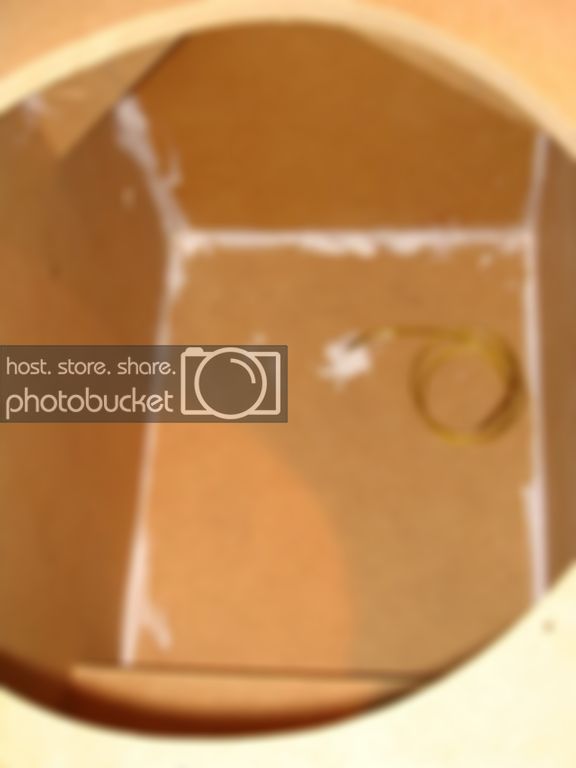

Sense everyone seemed worried that the sub would destroy the box, I put in some braces, 4 traingles-
And I mounted them like this-
And then I jizzed alover the inside of the box because it's just so sexy-
