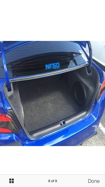

Iv pretty much found exactly what I want to build. Does this seem within reach for a first timer?
What do you plan to use as a base to create curves and all?
You can always make a mold and make it thick glass so its pure fiber glass.

I think I'm going to use mdf as the front piece. Paint the fiberglass to merge the two pieces together. I'm just not sure how I'm get that top piece so flat.
Your gonna have to sand the glass then primer

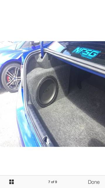

unless you do a lot of the structure out of wood you're going to use a gallon or more of resin. 1.5oz mat soaks it up like crazy and you'll want 4 solid layers of glass for those enclosures.

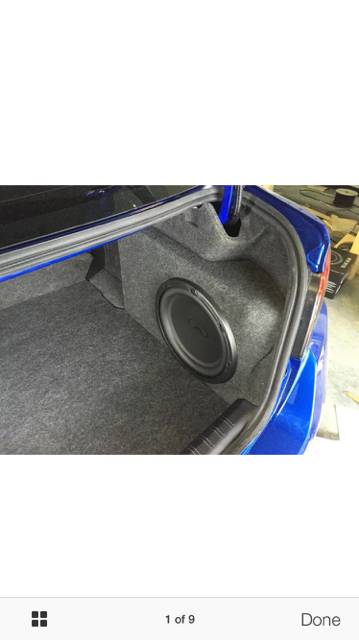

Going by the pics it does seem like a wood front/top with glassed rear/sides...
I would just be using the wood as the front piece. Everything behind that will be glass. Think I'll need more than one gallon for one enclosure? Or both?
