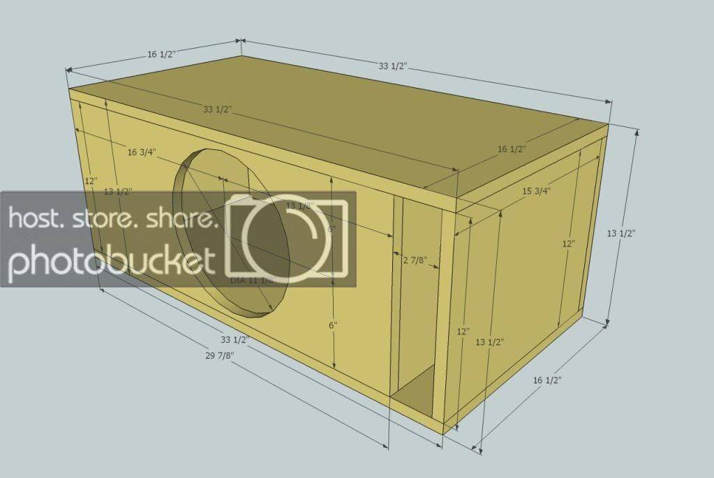

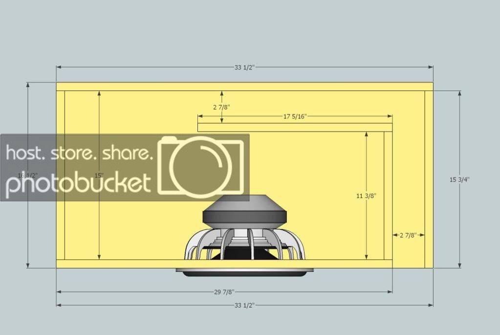

C Cloud77 Senior VIP Member 325 0 Cleveland, OH Dec 11, 2014 #10 This is the enclosure Fi modeled for the driver. 2.5 Cu ft. tuned @ 32Hz
OP The Camry Hey, I Try. 3,001 3 Western Oregon Dec 11, 2014 Thread Starter #11 yea i was looking at that. Curious. Should i add small 45 degree angles on all the corners for added airflow?
C Cloud77 Senior VIP Member 325 0 Cleveland, OH Dec 11, 2014 #12 you don't need to if you're following this design
OP The Camry Hey, I Try. 3,001 3 Western Oregon Dec 11, 2014 Thread Starter #13 Alright. Thank you much //content.invisioncic.com/y282845/emoticons/smile.gif.1ebc41e1811405b213edfc4622c41e27.gif
