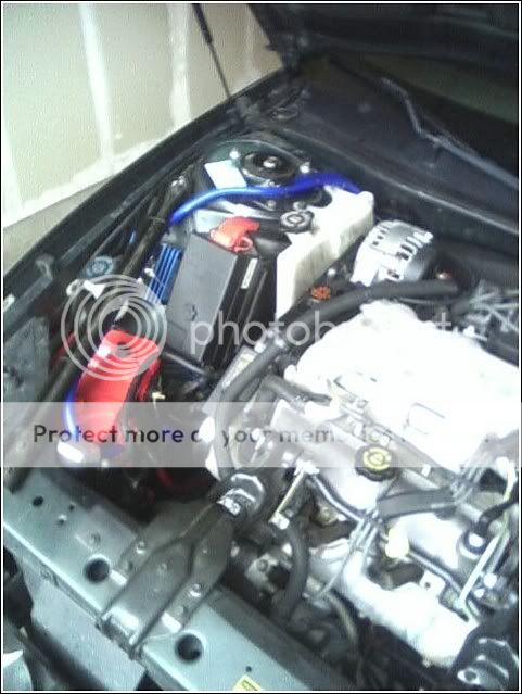

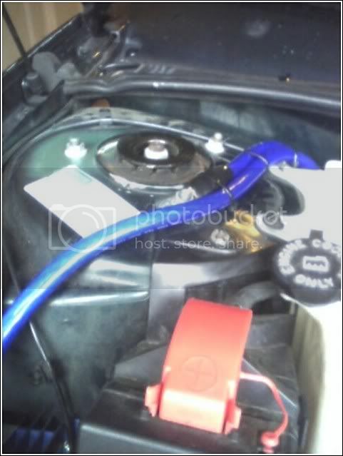

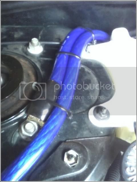

my big 3 needed some touchups, as well as my power and grounds in the back. for 2 spots where i had runs from the engine block to chasis, i had used this 19 strand 3/0awg from home depot. only problem is it's 19 thick strands, and seeign as how electrons like to flow on the surface area of the wire, the low strand count kinda sucked, so i replaced those 2 spots with good knu 1/0.

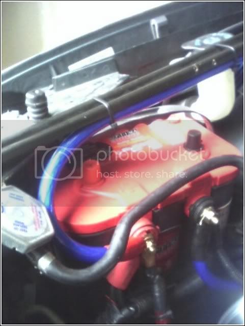

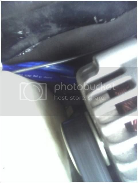

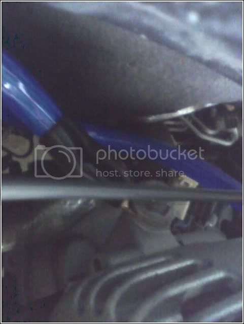

here's the 2 runs coming off teh alty to the battery. there's also one of the engine block to chasis runs goign over the alty, i ran outa wire to work with so i had to com up with a new spot (and that one works).

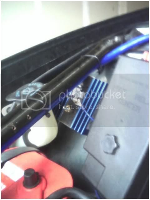

still kinda messy, and if anyone wants to donate me a fuse block so i can stop useing those nut connections ghetto rigged fuse block on the bottom, id be most aprreciative.

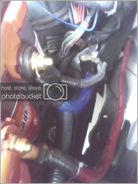

buuunch of grounds. those are my 3 off the battery (had an extra 2awg bat terminal post i threw in) and 1 off the engine block.
That's not true with DC. You would have been fine leaving it with the home depot wiring.
