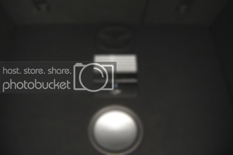

i put the piece(paneling) on top of everything and marked a spot where the amp and speaker were. then i cut a small hole. put it back on top of the amp,marked the amp with some masking tape so i could measure and get an idea how much farther i had to cut. i cut everything short and just kept trimming a little at a time.

there is nothing over the sub because i basically built that enclosure for a show i was in.
