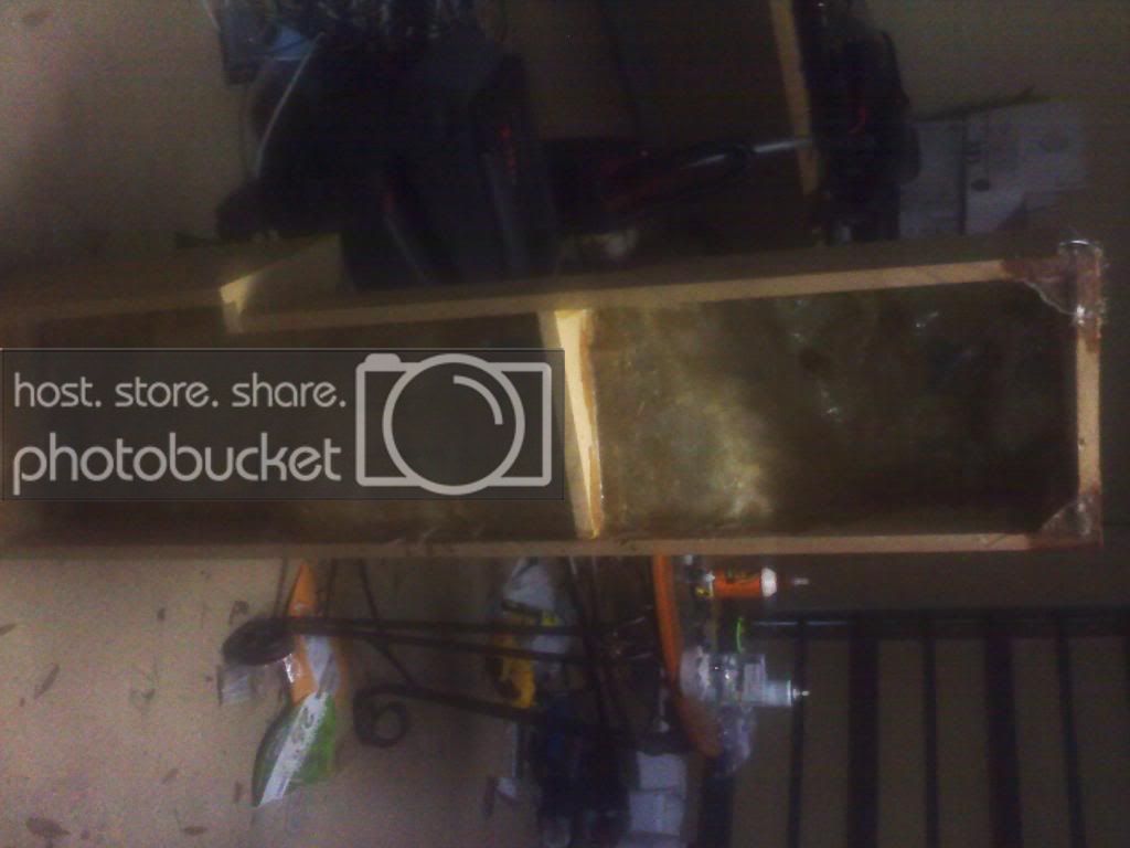

I decided to put a divider in the middle and run one 10 and one 8. the 10 ported and the 8 sealed. The fiberglass came out pretty solid for my first attempt at glassing.. Ill post a pic or two if I can get them uploaded. The only question I have now is what to make the port out of. Is there anything wrong with just running pvc out the back of the box?
I picked up a 1000watt amp and I'm getting two SA-8s, question is about the port size/length and whether or not to open the air space to both of them. Currently one side has about 1.4ft^3 and the other has .8ft^3. So if I open up the divider the overall airspace should be around 2.2ft^3. The recommended airspace is .75ft^3 per sub. I was thinking if they are separated I could tune one a little higher than the other and get a wider range out of them, or would they sound better in a shared airspace? Whichever is better I need advice on the port.

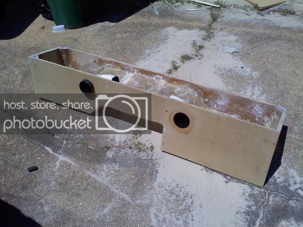

Here is how it sits at the moment
Update, airspace opened and 2 ports installed. Here is how it sits now
After the subs/bracing/port displacement I should be sitting at around 1.9ft^3. Is this good even though the subs recommended volume was .75ft^3 per sub? The two ports are each about 9" long which I believe puts me at 30hz. Is this correct?
