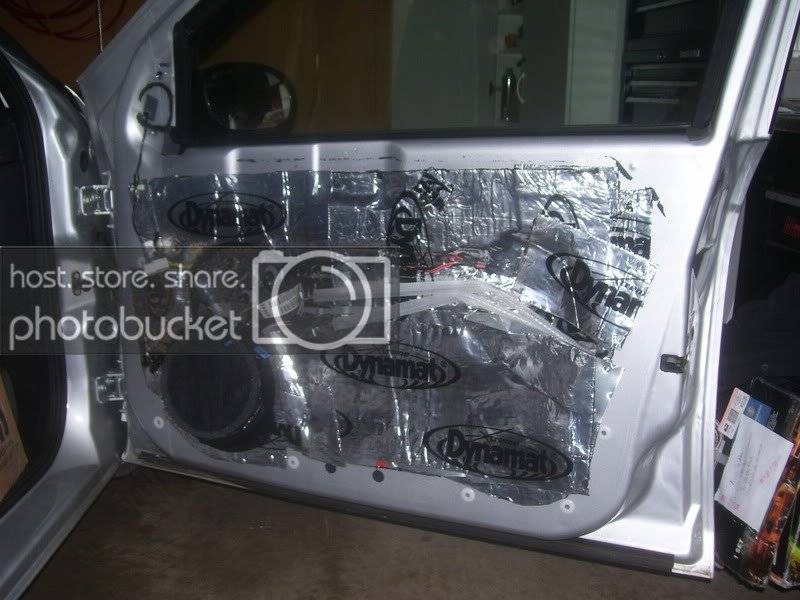

I have 36 square feet.left, I have done one door. I plan on doing all the doors and then dont know what to do after that. I have resonance coming from the exhaust at certain driving conditions. So I think that the flat panel behind the rear seats and maybe the roof could be important. I will get more dynamat as money allows.

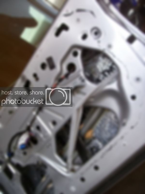

But when doing the doors, Is it very important to get the inside panel of the door (the one that is the actually divides the inside and outside)?

you want to put a layer on the inside of the outer skin and the inside of the inner skin.
you get what you pay for. peel n seal is not a vibration control product. it is a roofing product. there are tons of threads about it so start searching.
what you need is an MLV product Mass Loaded Vinyl barrier to combat "Airborne noises" such as loud exhaust in your case......Dynamat is a vibration damper
