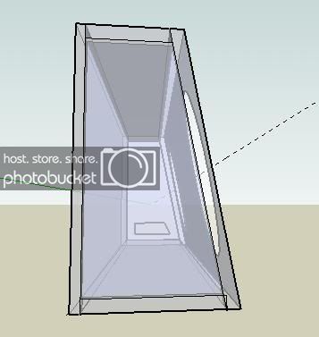

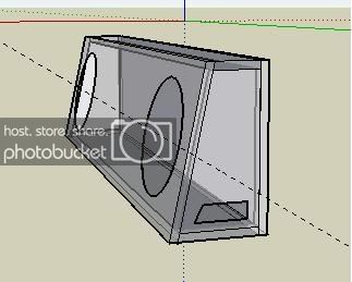

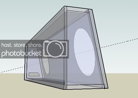

well im been trying to make this box and everytime something goes right another thing goes wrong idk ive been workign on it for like 5 hours but i cant get it to work
for example if i make a board like 2 secs later one side will be gone its soo frustrating //content.invisioncic.com/y282845/emoticons/crying.gif.ec0ebefe590df0251476573bc49e46d8.gif//content.invisioncic.com/y282845/emoticons/mad.gif.c18f003ab0ef8a0d9c27ca78d77a6392.gif
here are some scrn shots
once you make a panel double click on it, till the full panel is highlighted. then hit the make components button. and name the part. this will not allow that new panel to merge or change when you delet,move or modiffy other componets that are touchingl it. and you are still able to delete, move or modiffy that component.
