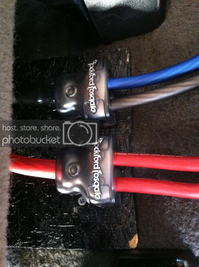

Heres a pic to help describe distro blocks. These are 1 1/0 in and 2 1/0 out which can also hold 4ga which is whats pictured.
