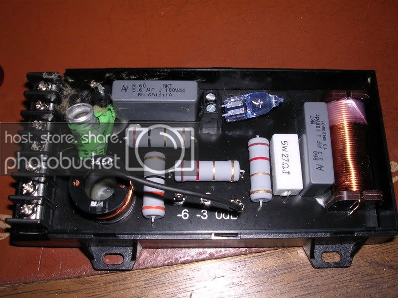

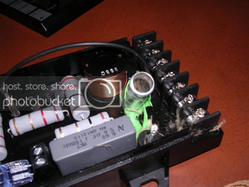

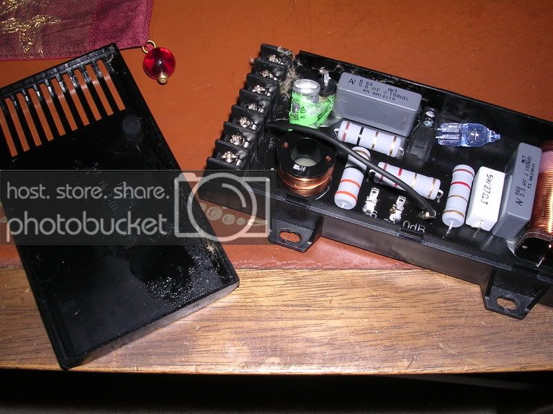

Do you have a pic of the xover? My guess is rainbow uses a protection in the xover which is the light that you saw glowing. Chances are it could be a faulty xover, Speaker wires are grounding out, amp is defective, or your amp was sending way to much power to the xover. Is everything else in the system working fine, or was it just the speakers ?
yeah i can get one pic, looks like the capacitor exploded. i don't think profile is overrated....everything else works fine, only the speakers and frontstage amp were acting up. Sub and sub amp was absolutely fine.
I'm almost positive it wasn't the wire, because i covered that sucker is so much electrical tape (where i made the splice) that nothing should have even dented it.. 16AWG speaker wire all around from Lightning and Knukonceptz, everything looked fine....
that capacitor just got nuked...one of them isn't even their any more, it melted
Here are some pictures:
if all the wire is fine it is either the amp or the xover that was faulty //content.invisioncic.com/y282845/emoticons/frown.gif.a3531fa0534503350665a1e957861287.gif I would just get the speakers replaced under warranty and reinstall them providing its not the amp. That poor little 100v cap got owned lol.

Im kinda surprised that it looks like Rainbow uses electrolytic caps instead of poly considering their reputation for quality sound.
I was really surprised to see that too. Sorry to hear about your luck. Hopefully Rainbow will cover you.
