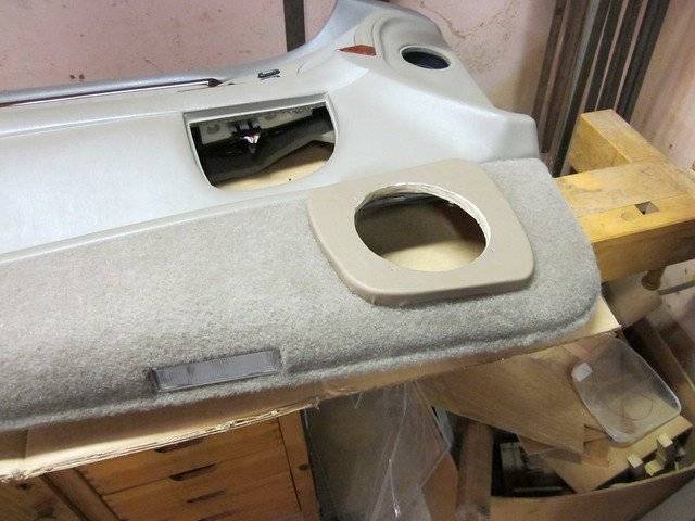

For background, I've resorted to mounting the speakers to the outside of my doors because the factory mountings were very lame. Door skins are damped with Raamat and a sq ft piece of acoustic foam behind the speakers. Speakers are mounted to a 1/2" thick plywood baffle covered in vinyl:
The hole above the baffle is for the door handle. It gets filled with a plastic insert that's been Raamatted on the back.
Speakers are HAT Imagine 5.25's with coaxial tweeters.
The problem is that the midbass is muddy and undefined. Midrange sounds "hollow" like the speakers are playing from inside a tube. Certain guitar notes "plink" with a noticeable resonance. I'm fairly certain that the culprit is the door panel itself, which is a heavy gage plastic padded with carpet and leather (love my Buick).
I've put deadening on the back side of the door panels, but haven't gone crazy with it. There are wires and switches and whatnot that I want to keep accessable.

It's impossible to really seal the panel to the door, since the panel is wrapped with upholstery. But the more I listen, the more I'm convinced that the plastic door panel is resonating. I'ma gonna deaden the living snot out of it and see how that goes.
